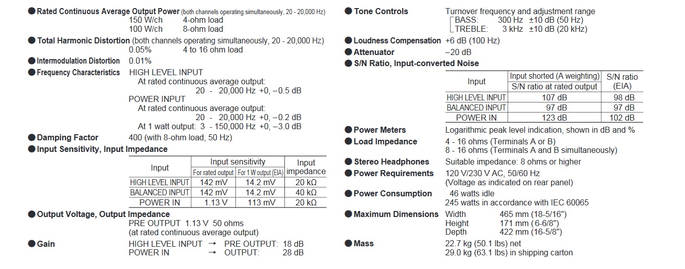

@PENG I think I'm getting the hang of it. So, even a 60Wpch into 8 that can handle 4ohms easily is more than enough and KEF's proverbial hunger should be catered to with the amp behaving nicely at 4Ohms?

Albeit, I wasn't going for 230. I wanted a 100 into 8 with a stroll of 150 into 4, like this:
This is something I wouldn't mind sticking to and passing it on to my nephews. They seem to be taking into listening to music.
These measures are taken in accordance with EIA Standard RS-490

If you are going to be using those speakers in a small (say by THX standard) room sitting 6 to 8' from them, a 60/100W 8/4 ohm amp should get you 100 to 103 dB of spl. That means you can listen to spl of 80 dB and still have clean power on hand for peaks of up to 23 dB above the average spl. 103 dB is getting close to the speaker's maximum output capability of 106 dB. So an amp rated for 60/100 W, 8/4 ohm could in fact be more than enough, depending on your spl requirements, room size and sitting distance.
The 100/150 W 8/4 ohm integrated amp specs you attached is impressive. It should be capable of pushing the passive LS50s very close to their 106 dB limits.
That integrated amp has very good specs, it should be powerful enough to push the LS50 close to their 106 dB/1m limit.
That integrated amp should be just about capable of pushing the LS50 to their limits.
