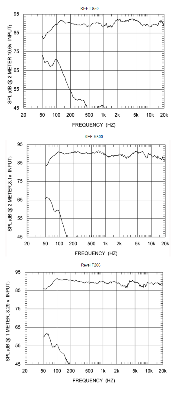

The distortion measurement is plotted at 2m, as opposed to the base FR:
So 96dB at 1m, or 86.5dB at 3m, ignoring the additional SPL going in room vs an anechoic chamber.
Meanwhile, 95dB @ 2m on the R500s:
Crossed at 120Hz to the Funks, they stay very clean for anything I throw at them.

I don't know that anyone expects the R500s to play with well executed speakers running north of $20,000 :D
Here are the LS50, R500, and the more comparable (but still larger and costlier) Revel F206s:
Not exactly a bad showing in my book, and it shows the limitations of trying to use a small monitor speaker at high levels vs something with a little more meat on its bones. Also interesting to the similarities in response between the R500 and the Revel, and the different voicing of the LS50.

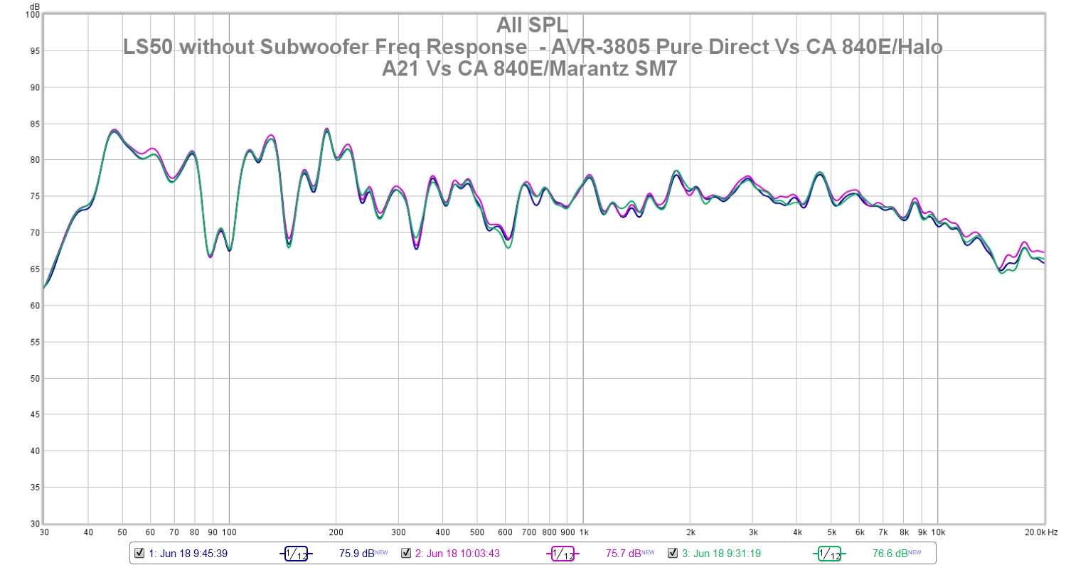

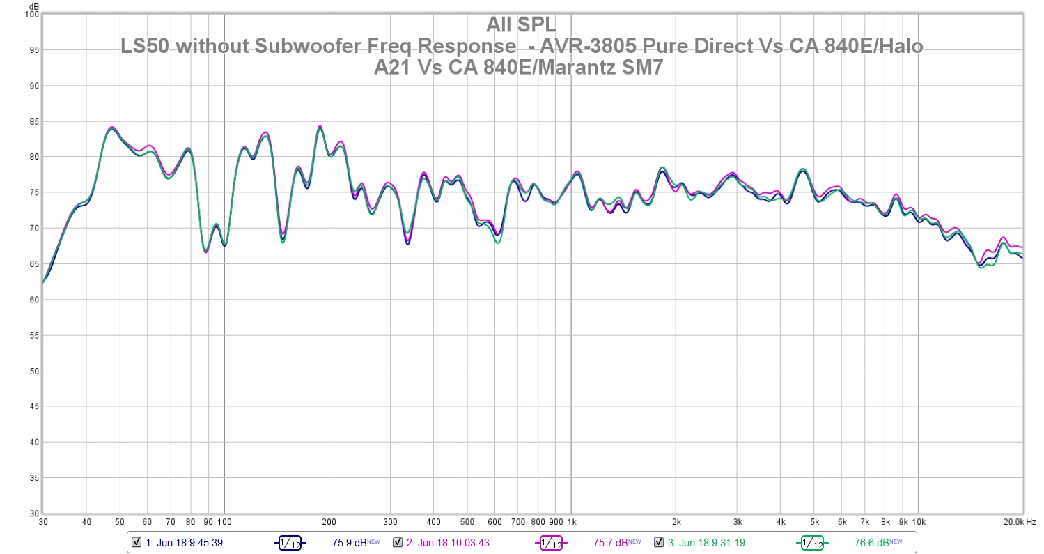

Room size is about 11.5X25X9 ft, mic was about 10 ft from the speakers. To get 70-75 dB from 10 ft, power draw would be less than 0.5W (much less most of the time) average per channel, based on the power meter readings on the SM7 as well as measurements I took in several occasions.
I plotted some graphs with REW under the same conditions, just to see how their FR compared, as heard by the mic.
So, what do you make of all this "power hungry" business? And what would be the easiest way to figure this; let's say your speakers dip to 3.9Ohm at certain freq. is it enough to just check how your amp deals with 4Ohm. For example, if it can handle 4Ohm, dips shouldn't bother it. Is this all there is to it? Does this cover all the "transients" stuff?
You can use online calculators, one of the better and easy to use one linked here often, is known as the peak spl calculator:
http://myhometheater.homestead.com/splcalculator.html
I have developed spreadsheets for different scenarios and parameters but the online one linked above is good enough for most situations. It is based on speaker sensitivity of x dB at 1W and 1 meter so you don't need to worry about impedance, but if the speaker's impedance spec is based on x dB at 2.83V, 1m instead of 1W, 1m, then you do have to know the speaker's nominal impedance and minimum impedance, and then you have to de-rate the sensitivity accordingly before plugging that into the spl calculator.
The influential factors typically include how loud one listens to, the sitting distance/room dimensions, and of course the sensitivity of the speakers. Dips to 4 ohm or 3.5 ohm alone doesn't mean a whole lot, for example there are many HTIAB speakers and subwoofers that are rated 4 ohms or below. I have seen some in value village that are rated 2.5 ohms, yet their proud owners usually wouldn't feel the need to power them with big amps.:D
It would be easier to demo how to do go about this if you can specific a speaker, with detailed specs.
