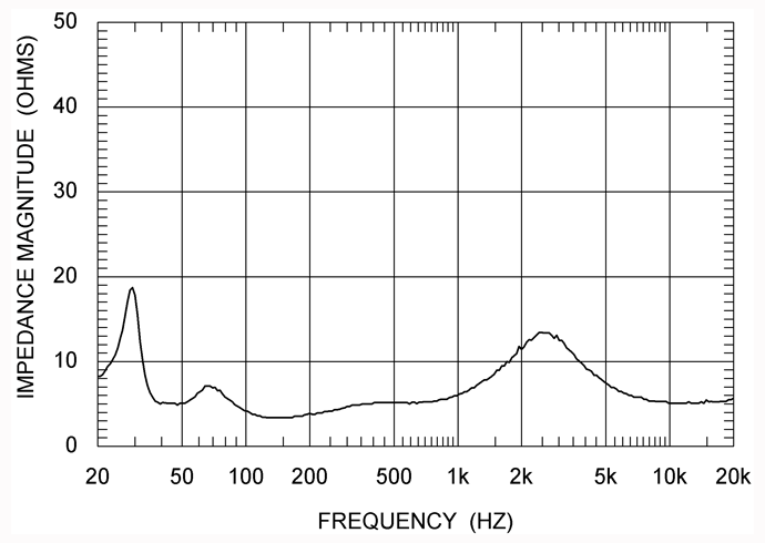

R500
https://www.soundstagenetwork.com/images/stories/loudspeakermeasurements/kef_r500/impedance.gif

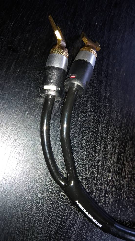

These cables are pretty bad ass for the price. Mediabridge. Hopefully they work as good as they look and feel.

They're fine and will work great. Do check tightness of the binding posts on them now & then though.

You were right about the spades. They are hard to crank down. I can see them loosening with any little movement or vibrations. Plus, the Denon didn't accept the spades on its end so I had to cut them off. I will get banana plugged wires.
