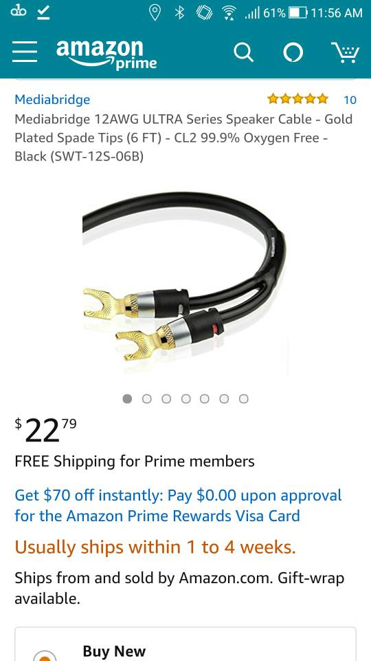

Ken, what gauge/type of wire/cable do you use with your R's?
Monoprice has a good deal on a 16g, 10' set with bananaplugs on them already.

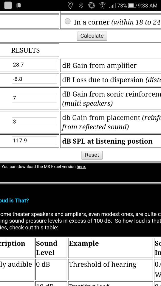

Thank you Peng. According to this, I should be doing just fine.
We will see. I still want an external stereo amp for the clearest music listening possible, but I think I'm good for now, until I build up my cookie jar audio funds again in the near future.

I just ordered the cables pictured, they're arriving Wednesday.
I have an HDMI cable that should work, but just in case I ordered another one of those.

I asked you about what type of cables to get, you never answered my question, do i hit some other forums and more people recommended the spades than the bananas. The ones I bought are soldered, so they shouldn't come loose, but we will see. I figured with the screw actually biting into them it would be a better connection.

I don't think you entered the right numbers. From the partial results I could see (the image's too big)It looks like your sitting distance is 9 ft. Based on the specified sensitivity of 88 dB/2.83V/1m and assuming average impedance is 4 ohm (don't believe in their so called nominal impedance), the sensitivity would be effectively 85 dB/1W/1m. According to the calculator you should get almost 100 to 103 dB with one speaker placed near the wall, that's about 2 to 5 dB short of the THX standard. THX standard spl is too loud for a lot of people, so you may be fine.
There is a review on the AVR-X3400H with some bench test data, linked below in case you have not read it.
https://www.soundandvision.com/content/denon-avr-x3400h-av-receiver-review

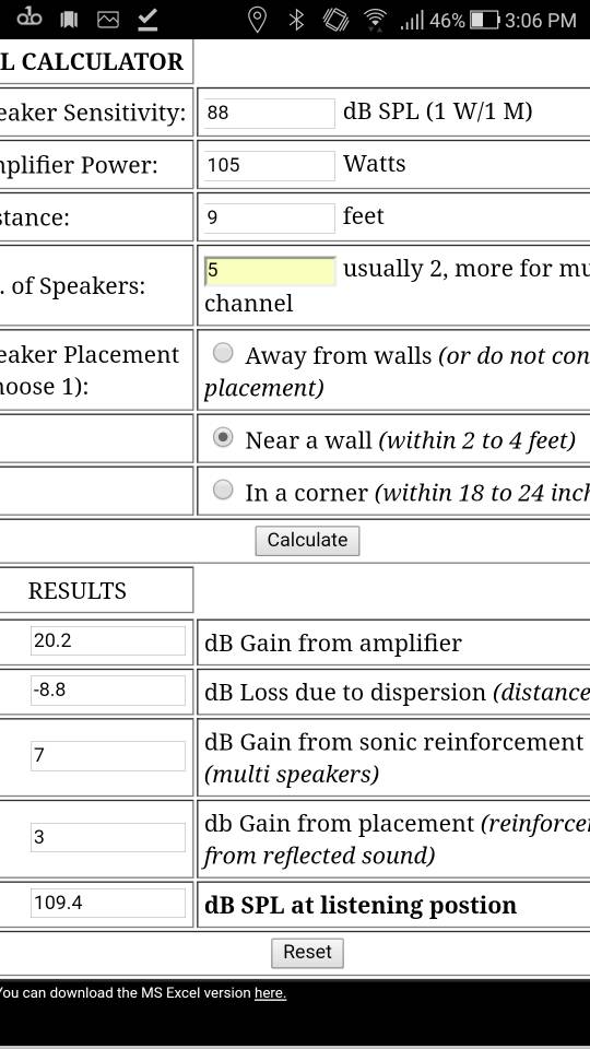

You may be right. I put in the total power of the amp. Not per channel. Let me reconfigure and I'll post it back on a reply.

The sitting distance is 9' but the room is obviously larger than that. Should I figure it to the back wall instead?
