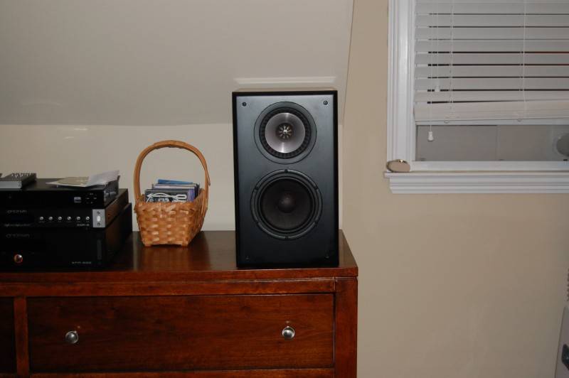

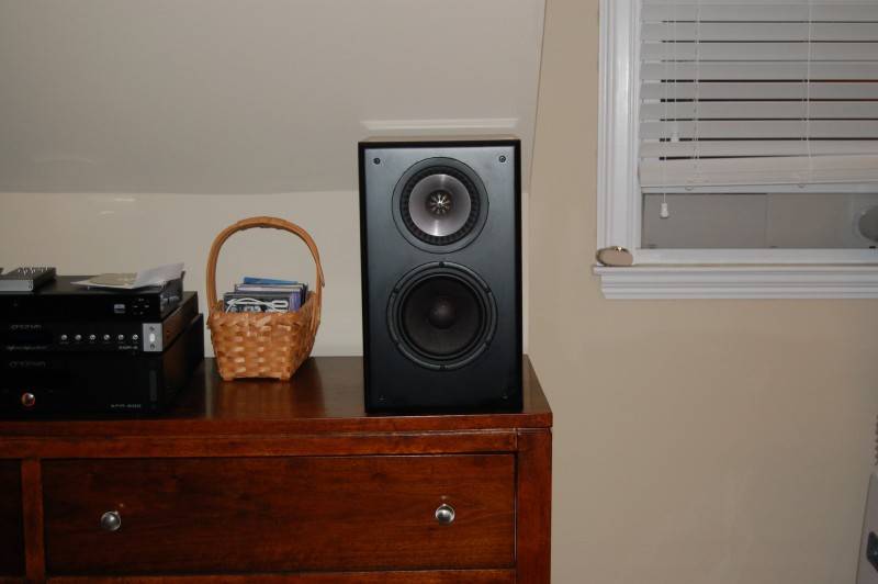

I can't speak to the LS50's specifically, but I've got a pair of custom speakers utilizing drivers from a pair of Q100s, and those certainly benefited from being crossed ~500Hz (and of course, the whole Dennis Murphy XO treatment).
IMHO, the end result is markedly better than the R300s I have for comparison, though I can't quite swing a set of Reference series speakers to see how they'd hold up in my room for a head to head competition :D

That's so cool. I'd always wondered what Dennis could do with those drivers because they're so good yet KEF skimped on crossover quality and cabinet to save money. Which woofer is used there, and in what cabinet? Do you know if he added any bracing inside it? That's a big part of the R series, better cabinets.

Seas ER18 woofer (7" version of what's used in the Salk SongTowers among others) and a Dayton 0.75CF cabinet. From what I recall, no additional bracing was added, but some damping material was. They're pretty inert on the knuckle rap test in any case.

Can you elaborate on what you think is better on your custom speakers vs your KEF R300s? I'm not doubting, just curious. I've never heard either.

Extension and frequency balance primarily. With respect to extension, the customs are in a much larger enclosure and the system was tuned about 10Hz deeper than the R300s, so no big surprise there. As far as the balance goes, you can see the FR of the R300s at S&V: reasonably flat, aside from that bump centered around 6-700Hz. I don't have the measurements Dennis gave me of the customs any more (that was ~5 years ago now), but they were remarkably flat except for one detail: he had to bump up the woofer just a tad to preserve the phase response of the system. The subjective result was that when the R300s were popped into the same position as the customs, they sounded downright thin in the upper bass / lower midrange by comparison.
Of course, there's a reason the R300s are still around: their problems were solved with placement and tweaking with EQ, they're more efficient, and considerably more attractive (a critical aspect for a system in the living room, vs the bedroom where the customs once again reside).
