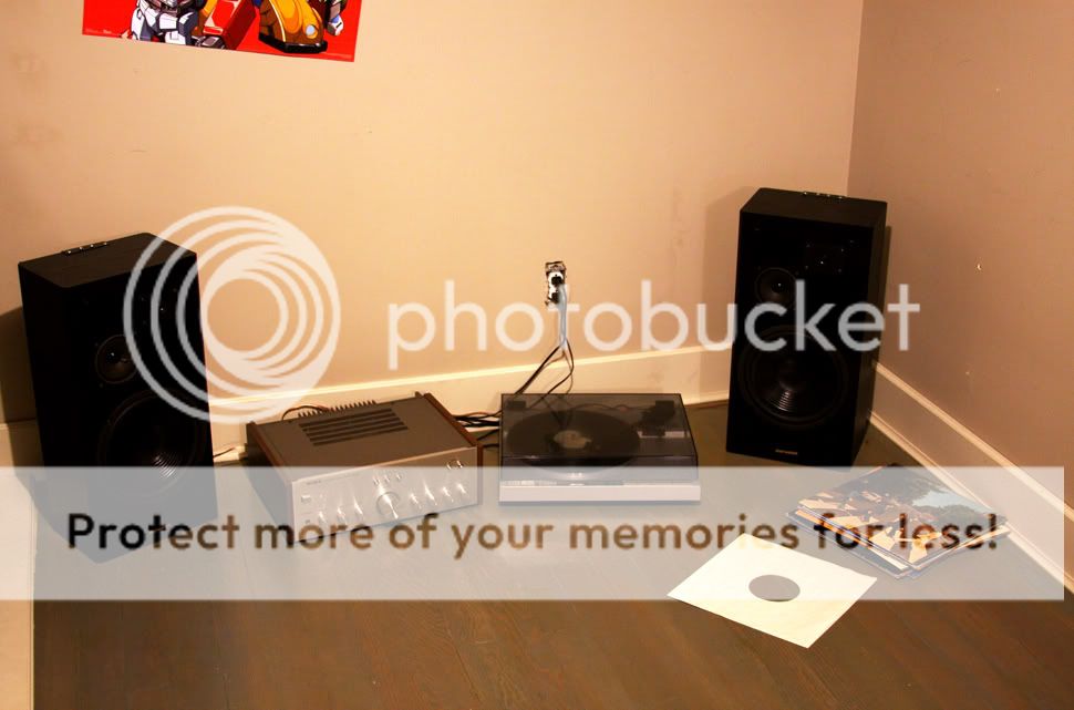

I was wondering if hooking my KEF iQ70 towers up to my vintage Sony TA-F3A would be a good idea. My Onkyo TX-SR606 doesn't have a phono input and I don't have a pre-amp. Any thoughts? Also, any suggestions for a new turntable are welcome (currently using a Yamaha P-25).
Yes, that is a transformers poster.
P.S. Is there a vintage thread? Searched and didn't find.

If you really don't want to buy any equipment right now, plug the turntable into the Sony's Phono input, connect an RCA cable from the Sony's REC OUT to one of the Onkyo's AUX inputs. Iit has an input labeled 'Phono', use that to keep it simple by setting both to Phone and never changing the inputs on the Sony. You can turn the Sony's speaker switch OFF if you want and hte volume control won't do anything, so leave that at minimum.
