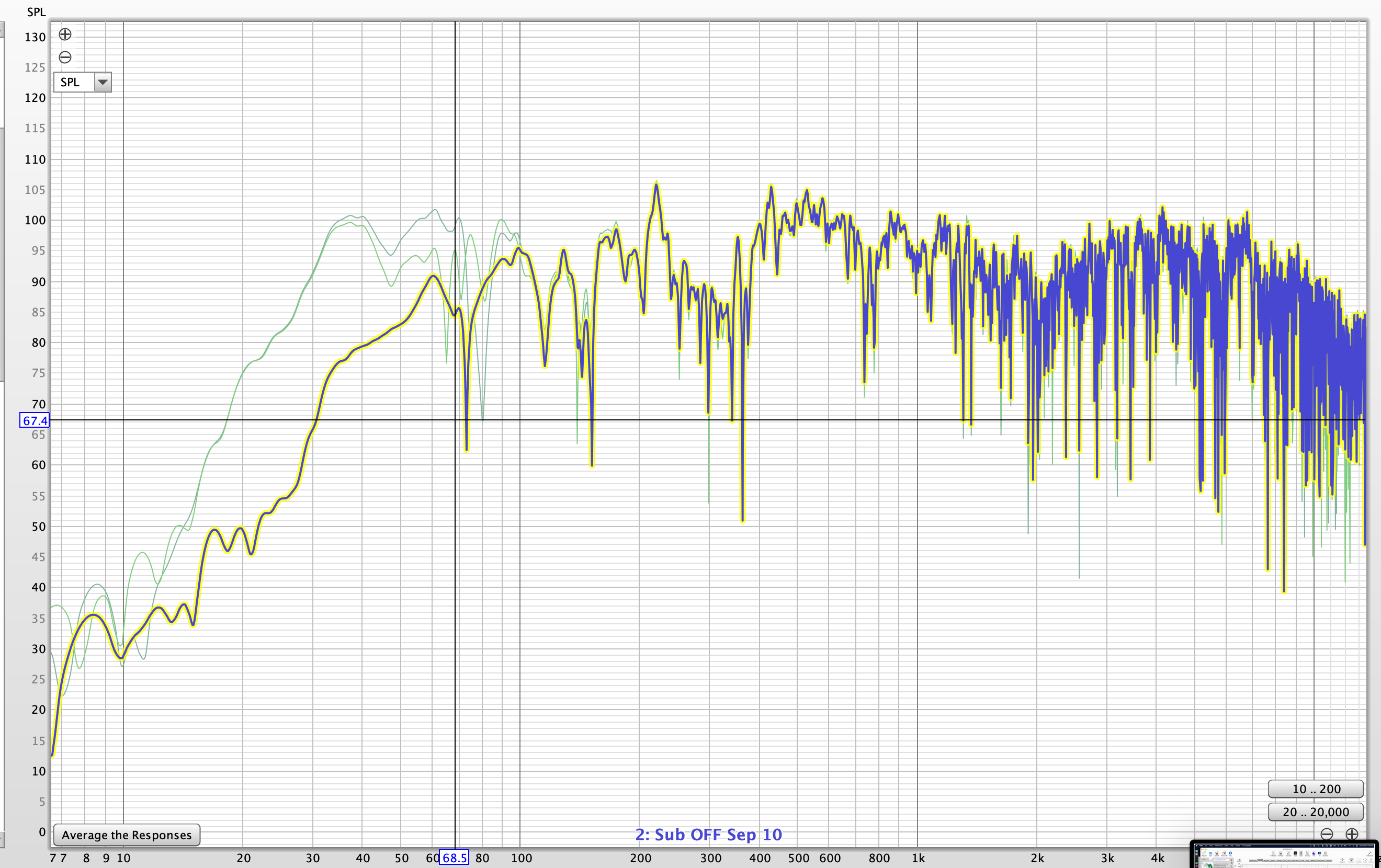

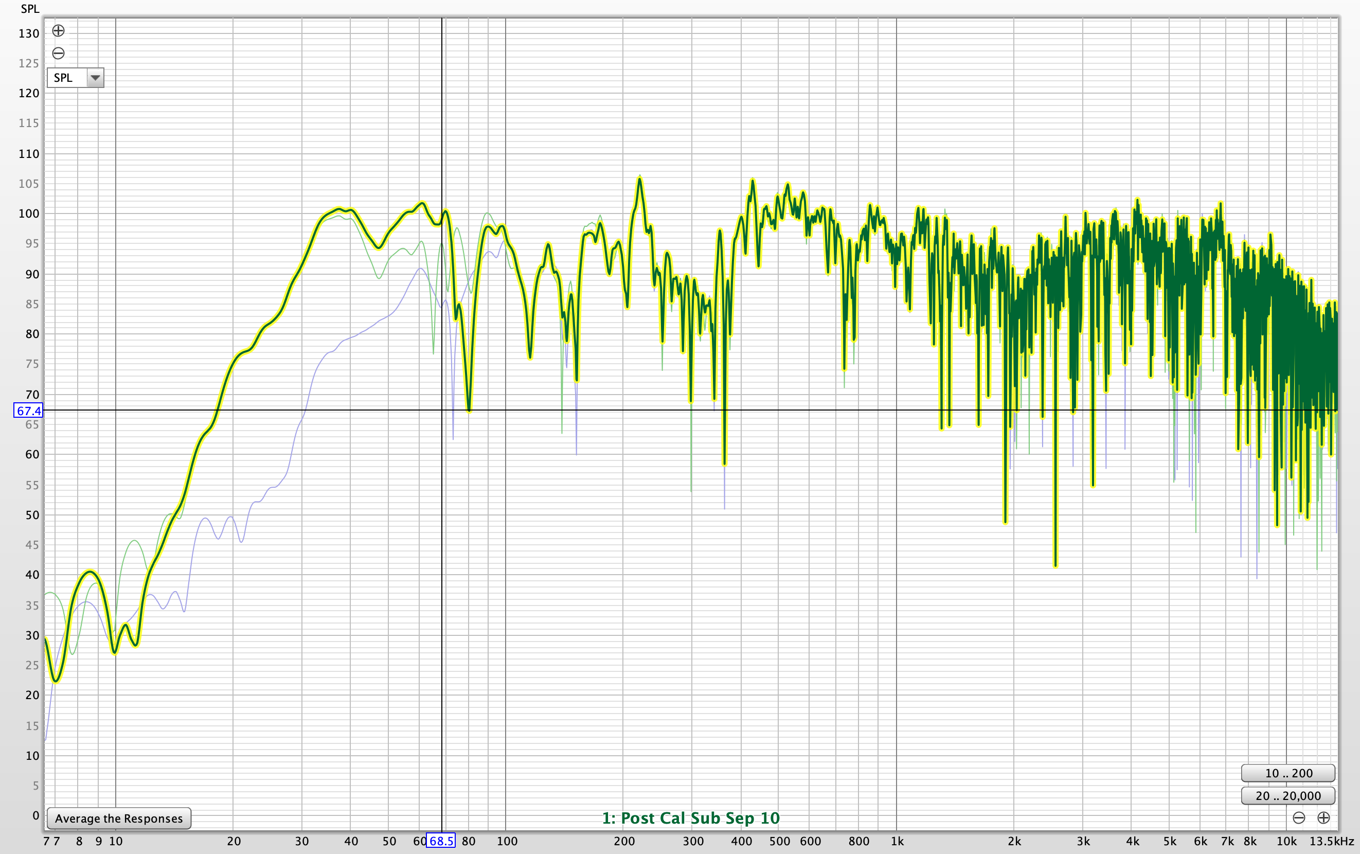

Took some measurements in REW and sure enough, there's a big deep null right around 70hz.

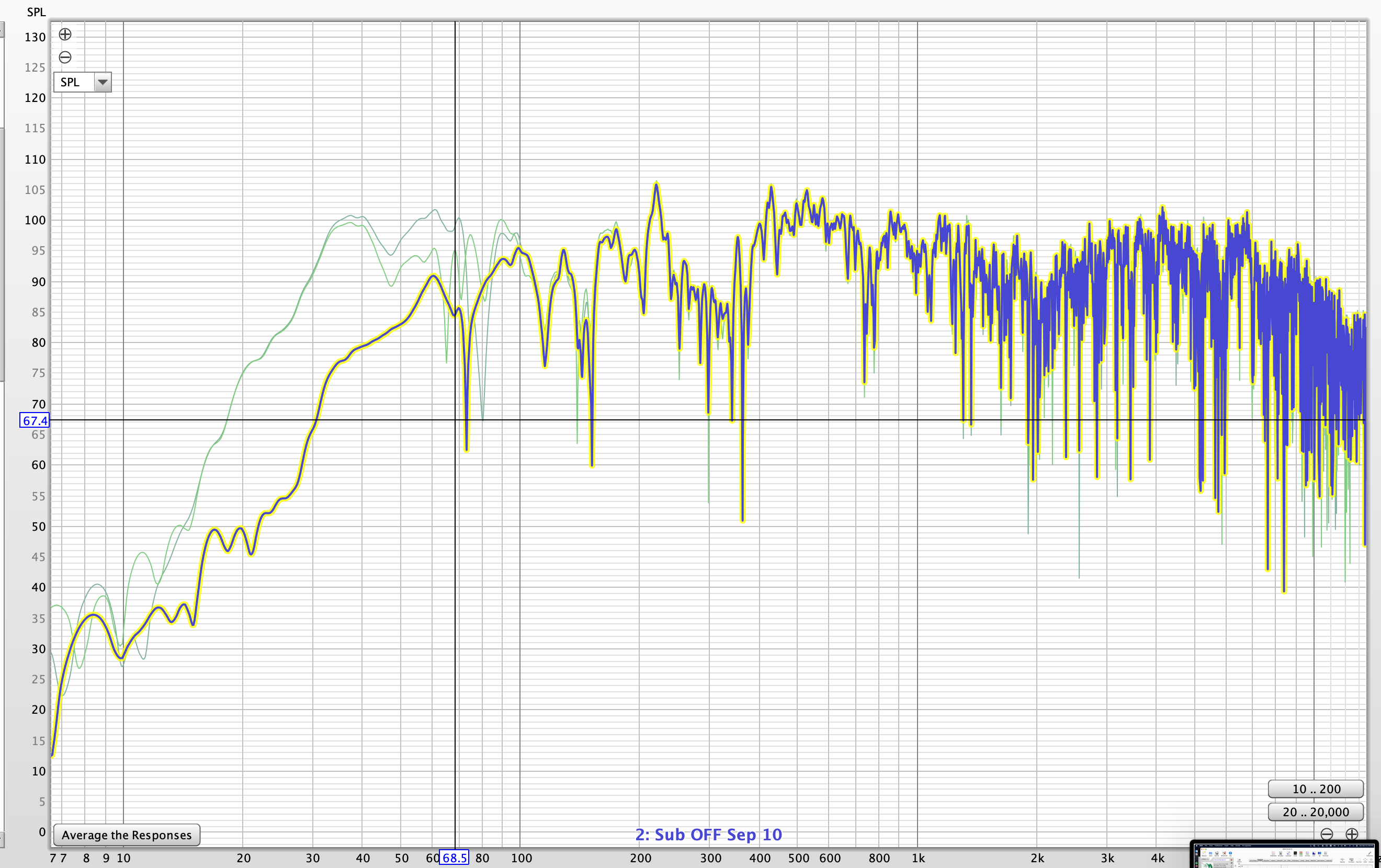

I then turned off the sub and re-measured and that null trough is still hovering around 70.

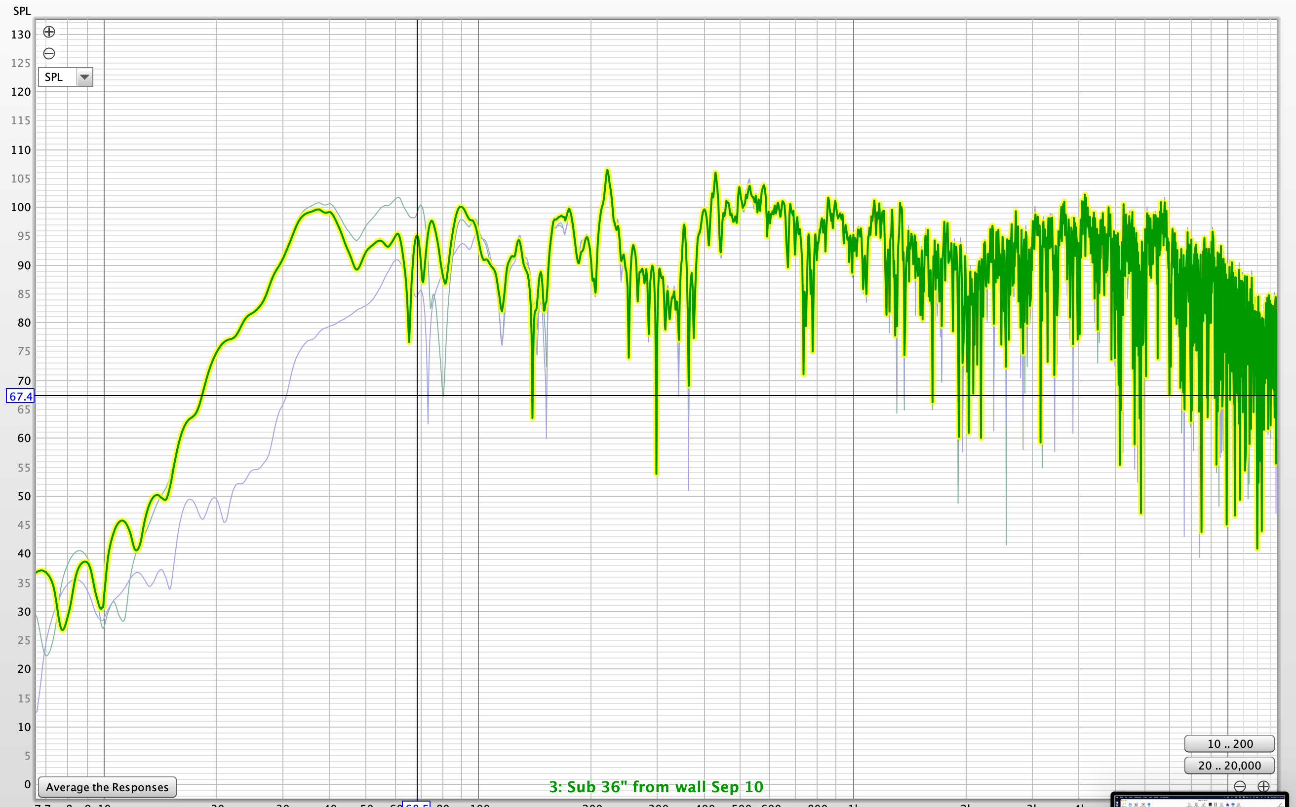

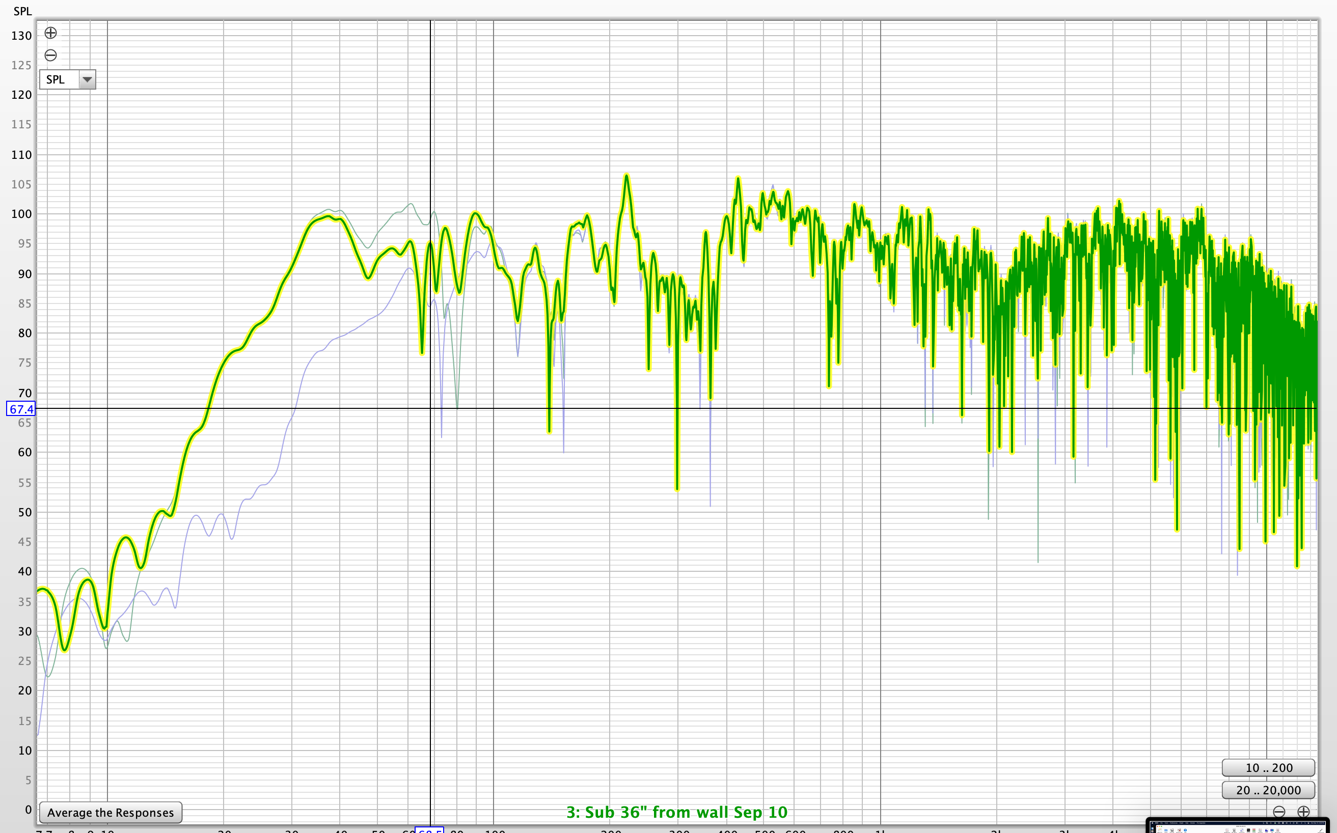

Before fudging with other settings, I decided to move the sub another couple feet from the wall.
Sure enough, the null got lessened a bit. So I'm thinking that I have some very bad nulls in my room and that somehow my old sub was covering them up perfectly? I don't have old REW measures from back then, but it was definitely more balanced and less notchy. It was a much smaller 10" Polk too.
Am I right in thinking that only way to know if I don't have a lemon sub is to take it out in a field and sine sweep it there? Or is it more likely it's the room and not the sub.
Before fudging with other settings, I decided to move the sub another couple feet from the wall.View attachment 63321
Much more likely to do with your room. Be more interesting if you had same mic position measurements to compare perhaps....are you using single mic location or multiple?

Ok so I ran REW and took measuremente but I'm not sure they are accurate.
For some reason REW recognizes my output device as the Epson projector and not the Yamaha. I can get output through the subs but still I need to be sure. I suspect it has to do with the EARC connection. I plan on hooking everything up to port 2 and see what happens tomorrow
So far it's looking just as I suspected if these measurements are correct. With room gain you can get extension to 30hz but after that nothing else. Which is fine for the bedroom and for such a good buy

I put my FV18's up front where my SVS and RBH subs had been in the movie room and they for some reason didn't measure well. I had to lay them on their sides and move them slightly at both positions to get the response I was looking for
I don't think you have a lemon. I think you have a weird room response and we all get those.
As you noticed moving it even a touch can make a difference as well as buying a second sub to smooth out the response
For $209 that's not a bad idea to get a second one
FYI I also don't think you have a lemon because my responses measured look a lot like yours. Especially with that dropoff at 40 to 30 Hz

I'm starting to suspect that these subs were designed that way. I don't think my measurements are off. I think they are made to play hard from like 30hz to about 80. But nothing really outside of that
I don't think your having a null at 70 Hz I think your experiencing their cutoff.
