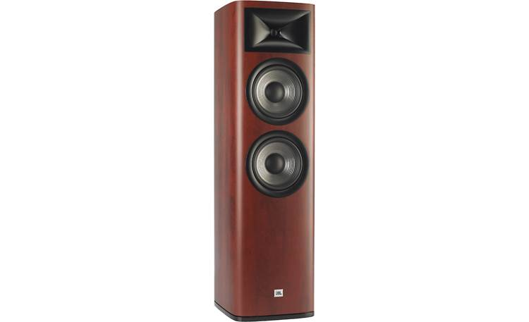

Well there are some pointers this is a marketer's design rather than an engineers design.
My concerns.
They have published no meaningful specs other than rudimentary information. The FR has no 3 db points and could mean anything.
They made it a three way when it did not need to be, which I bet was marketers. The design would be much more sound as a 2.5 way.
Here is why.
The cross to the mid, is at 320 Hz, so there are going to be some hefty inductor and capacitor values. This is a less than ideal crossover point and still within the BSC region for a cabinet of those dimensions. They were forced into this by the crossover to the HF horn at 1.8 KHz. That horn is the "flagship" component of the design. So they had to cross to the mid at that low a frequency in order to avoid excess bandpass gain.
So the issues become is that while there are two speakers below the crossover, that one mid is being driven in a definite power band region. So there is a good chance it will be power limited in its pass band.
All this was not necessary, as if it had been made a 2.5 way the 8" driver could easily have crossed to the horn at 1.8 KHz, and much easier solving of the BSC issue. This would have made for a less expensive and better crossover, and I suspect a better speaker.
When I see those sort of decisions, I can hear the marketers screaming at the engineers: - "We have to have a three way!"

To me that seems a far more sensible design. The 690 is exactly what I suggested. That is a 2.5 way. The 0.5 crossover is at 600 Hz which I would estimate to be right at the transition frequency. The cross to the horn tweeter is 1.7 KHz, and if those drivers are any good, it should be prior to cone break up. My strong hunch is that the 690 is likely the better speaker, as it has a far more logical design premise. I feel that the 698 was for the marketing department. All I see from the 698 is downsides over the 690.
The 690 are $100.00 cheaper each. So they are furnishing a mid range driver and low frequency high and low pass filters for $100. I could not build at decent crossover at that frequency for $100.00 I don't think. So this gives me greater suspicion the 698 is a sop to the marketing department. I see absolutely no good reason to complicate the sensible logical design of the 690.

The advantage is sales. The marketers know that in the publics mind three must be better than two.
The ONLY reason you add drivers is to keep drivers in their linear range, and operating out of cone break up range. Ideally there would be no crossover. Apart from that crossovers just add problems, especially time shifts and making the load more complex. Passive crossover are actually pretty crude devices, and the less the better. Active crossovers offer huge improvements but even then you don't want to use them gratuitously.
As far as these speakers are concerned it seems to me adding a mid is a gratuitous complication, and as I point out likely to add more problems than it solves. Since the 690 shows that those 8" drivers can be driven to cross to the horn, it suggest to me that adding a mid is unnecessary and meddlesome.
But you know three is better than two, to a marketer only smart enough to study that at college, or just wing it.

The studio 698 has 2 8” bass drivers crossed at 320hz and a dedicated 6” mid playing 320-1.8khz. 690 has 2 8” drivers playing everything below 600hz and one 8” pulling double duty playing mids as well from 600-1.7khz.
I’d like to hear both but I’d prefer the 698. The 6” mid will have more focus and control. The 690 might be the more bass heavy speaker too depending on content.
The Jbl 890 is a 4 way speaker. 2 8” play everything up to 700hz. 4” mid plays 700-5khz. Titanium tweeter 5khz-20khz. 20k and above gets a 3/4” dome in an aluminum horn.
It’s more important to listen to the speakers than to look at specs though.

There may be some reasonable rationales for going 3-way in those speakers. Maybe the 8" just doesn't work as well near the crossover frequency, and the 6" is better behaved. Maybe the 6" works better for the type of controlled directivity they were looking for. We don't really know. A 2-way or 2.5-way might be more optimal, but I don't think a 3-way would necessarily be bad for this kind of speaker. 2.5-way is the route that JBL took with the higher-end HDI-3800, but those used different drivers. I would need more information before saying that a 3-way is just pure marketing here.
Personally I would like a large HF driver and dual 10” or dual 12” woofers.
But how they measure in the end is the salient thing (along with how they sound), right?
Dynamic (plays high SPL with less distortion) and accuracy (linear FR and other measurements) will put all this to rest.
JBL also engineers or manufactures their own drivers to a higher level of compatibility to start with, so it's not quite the same as having to source ultimately compatible 2nd or 3rd party drivers in bulk, within a set manufacturing budget and then torture them to play nice together after the fact, as many designs do. Is why so many of their budget designs end up performing beyond what they cost, seemingly defying cost/performance market trends, which is certainly the case with the 590 and others of that series.
What I like about JBL is that the much of the tradeoffs tend to be with not forcing us to buy otherwise superfluous (albeit very expensive) cabinet dressings and hardware. Many speakers have the performance/aesthetic standards somewhat backwards.
