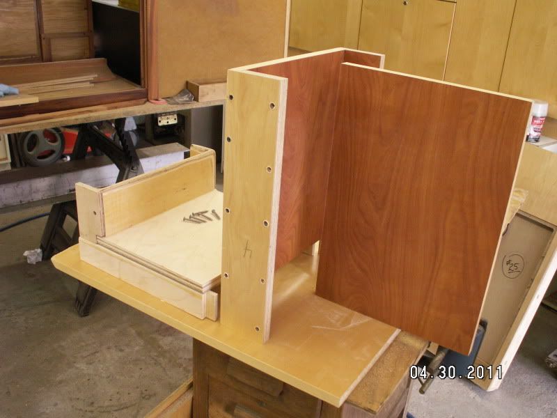

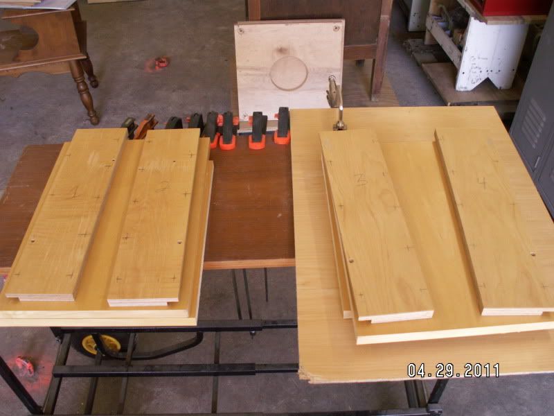

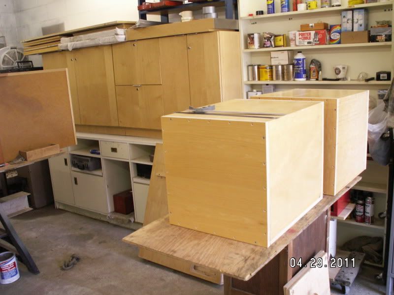

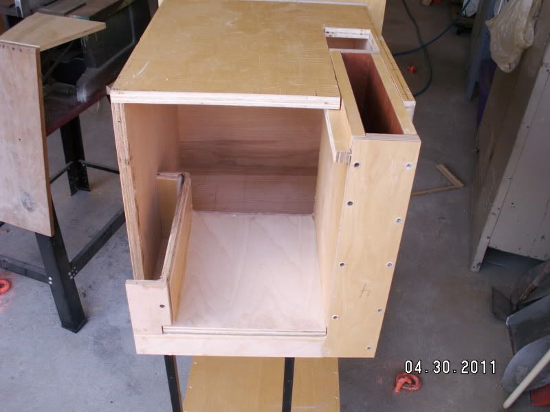

Doesn't look like much, does it?
The front baffle and sides are plywood and the top, bottom and back are presswood.
The first one is on it's back.
This is the mouth of the port assembly before assembly.
It will get plastic laminate instead of the usual black paint.
I got the alignment from TLS Guy about 3 years ago. On my last job I garbage picked the wood. Annunaki makes it look simple and maybe for him it is but I have no auto pilot to fall back on. When I get tired the mistakes happen. After pretty much two days this is all I got ... not to mention all the time spent working on design, layout and trying to conform to the various spec's.
DIY is much easier when you get somebody else to do it for you.
Considering DIY but paying some one..lol
This is in fact my first goat roping and it's not how I envisioned it at all.
So far I still got all my fingers and toes.

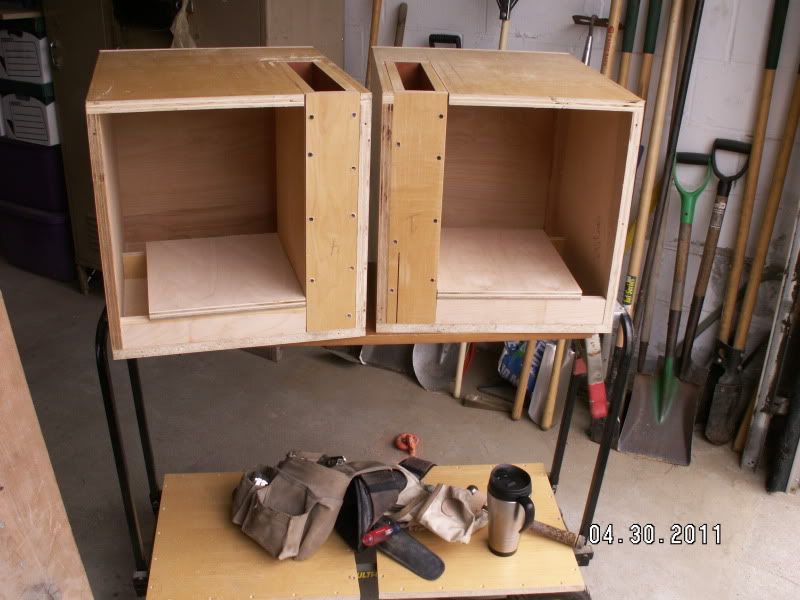

I feel like I'm even more [of a] noob than Alex.. :eek: Are you making pair of subs?? :confused:
Yep. This is really a practice run for me to get somewhat familiar with the process and to see what these subs will do.

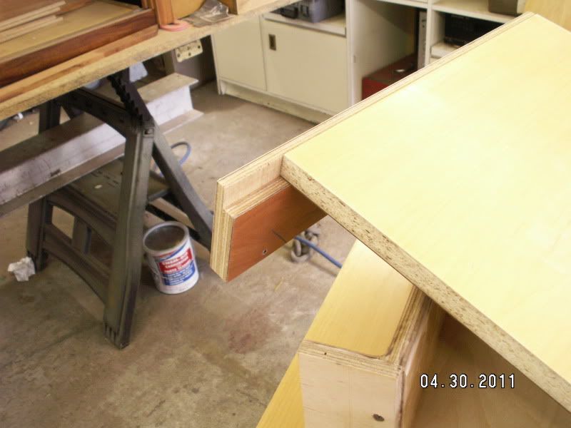

Ohhhh ... you mean like these pic's showing how the assembled vent just slides right in?
... and like these pic's showing those fancy joints and plastic laminate on the inside of the vent?
It does look easy, doesn't it? :D
What drivers are you putting in those?
JBL GTx10's ... Eddy of the Deck had them kicking around so they were free like the wood. I purposely doubled up the vent wall against the exterior wall so the vent would have a meatier boundary than just the 3/4" of the enclosure.

Now is the time for me to be thinking about bracing.

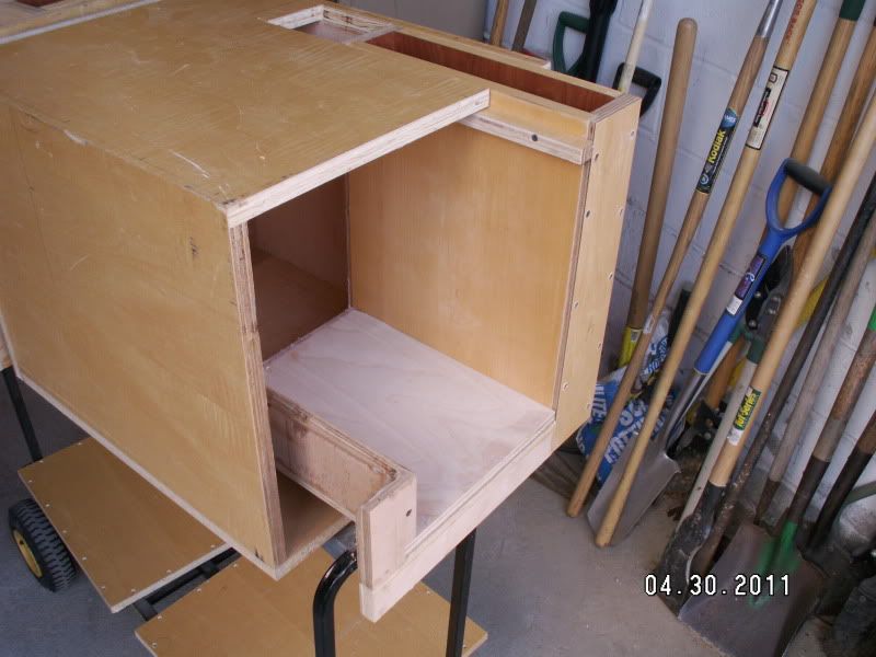

Nice looking work on those vent assemblies. Using laminate board is a good idea. It seals the vent inside surfaces the easy way.
After looking at this photo, I wonder if those two layers of ply, one from the vent assembly and the other from the box wall, will vibrate against each other. A few screws and/or adhesive should prevent that. Did you have any other ideas for that?

That needs to be sealed? :eek: ... I mean yeah, of course ... that's why I did it. :rolleyes: I guess I'll spray the other internal vent surfaces then. I think I have some spray poly there. I only did that for looks and now that I think of it it'll hide dust better and be easier to keep clean.
I take it you mean my cleat to support the cut portion of the baffle? I'll screw and glue everything before it's all said and done. I'm getting a little antsy and think I'm going to just add a few screws, slap the bottom back on and get the drivers in there to do a quick and dirty test. If for some reason either of those drivers is fubar I want to know before I assemble the other vent and brace up both enclosures ... plus I need the reward factor and promise of better things to follow. ;)
Seal all the inner surfaces if you worry that the wood will swell & shrink with changes in humidity during the year. Aren't you the guy who said you should judge a carpenter by how he does finish work inside a closet? If this cabinet is just the trial version that you will build again later with nicer materials, then nevermind. But if you think you might keep them and (did you say earlier you would cover them with black laminate?) you should put some kind of sealer coat on the bare wood inside the cabinet. I always wonder if this is really necessary with a plywood or MDF speaker cabinet, but it's easy to do, so why not?
Yes, any point where the vent assembly touches the inner surface of the cabinet can vibrate. It's just like a bookshelf speaker sitting on a flat shelf without any rubber feet. A quick & dirty test with the driver will let you know if more screws or glue is needed.
It's not a trial version. I think these materials are good enough for these drivers. Before I go crazy with braces I want to see each driver installed and functioning without any mechanical issues. Then I'll brace them up properly and seal the innards as you suggest. I haven't decided on a exterior finish but not black laminate. First of all I don't have any black laminate. I do have a whole mess of Mahogany to clad it with ... maybe just paint. I'll see. :confused:
With press wood and MDF it is necessary to seal all sides so the wood doesn't absorb moisture from the atmosphere and warp toward the finished side from expanding as those materials are know for in the presence of moisture. Since this is reclaimed wood (Tiger Maple veneered panels hanging in high end office space) I got to see the subtle effects not sealing all sides had over time. Bracing would have stopped the warping but under the stress of being in a sub I imagine it would only further compromise the integrity of the medium but I'm talking above my pay grade here.
... any point where the vent assembly touches the inner surface of the cabinet can vibrate. It's just like a bookshelf speaker sitting on a flat shelf without any rubber feet. A quick & dirty test with the driver will let you know if more screws or glue is needed.
I'm down with overkill on all that. I'm going to use screws first and then disassemble, clean off all burrs, glue and re-screw everything last. Glue makes you pay hard for your mistakes. Dry fitting is key especially as how I am going with these ideas as they come. As a matter of fact I glued that cleat to the vent. That's a mistake. Now I can't pick the vent up to get glue under the bottom part of the vent as it is pictured ... it will only slide out, not up.
