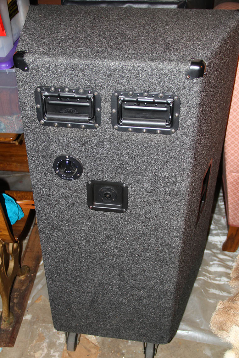

So the speakers are not the same? If you can send pictures and model numbers that would be great.
I looked on line at JBL pro speakers of that era and found nothing like the one in the photograph.
Also JBL speakers of that date and using similar sized woofers had one or two ports of that size, generally one. It just looks to me as if there is far too much port area.

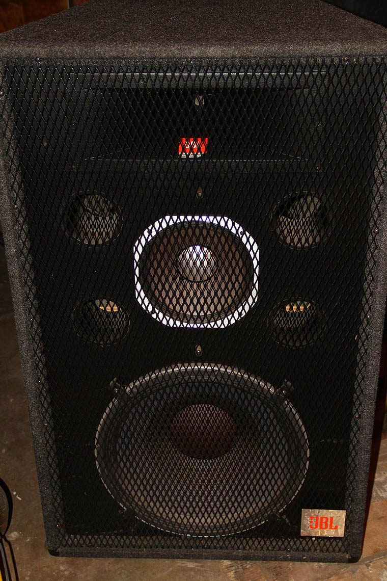

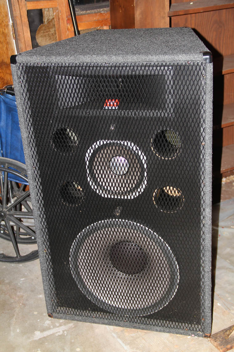

Looking through the cabinet screens, the drivers appear to be the same, at least in size and coloration. As mentioned in the early postings, the only driver with a visible model number is the JBL 2370A horn, found topmost in each of the four. lovinthehd, early on asked me to open the cabinets and pull the drivers to look for numbers; I really don't want to get this deep into them if I don't have to. Here are some images:
I'm sure those are not JBL speakers. They are speakers built with JBL parts.

TLS Guy - I'll probably never know if the midrange and the woofer are JBL but the 2370A horn is even labeled JBL. :rolleyes:
The drivers may be JBL, but that doesn't mean the speaker cabinets or crossovers are (designed and built by) JBL...one way to find out, tho. :)
