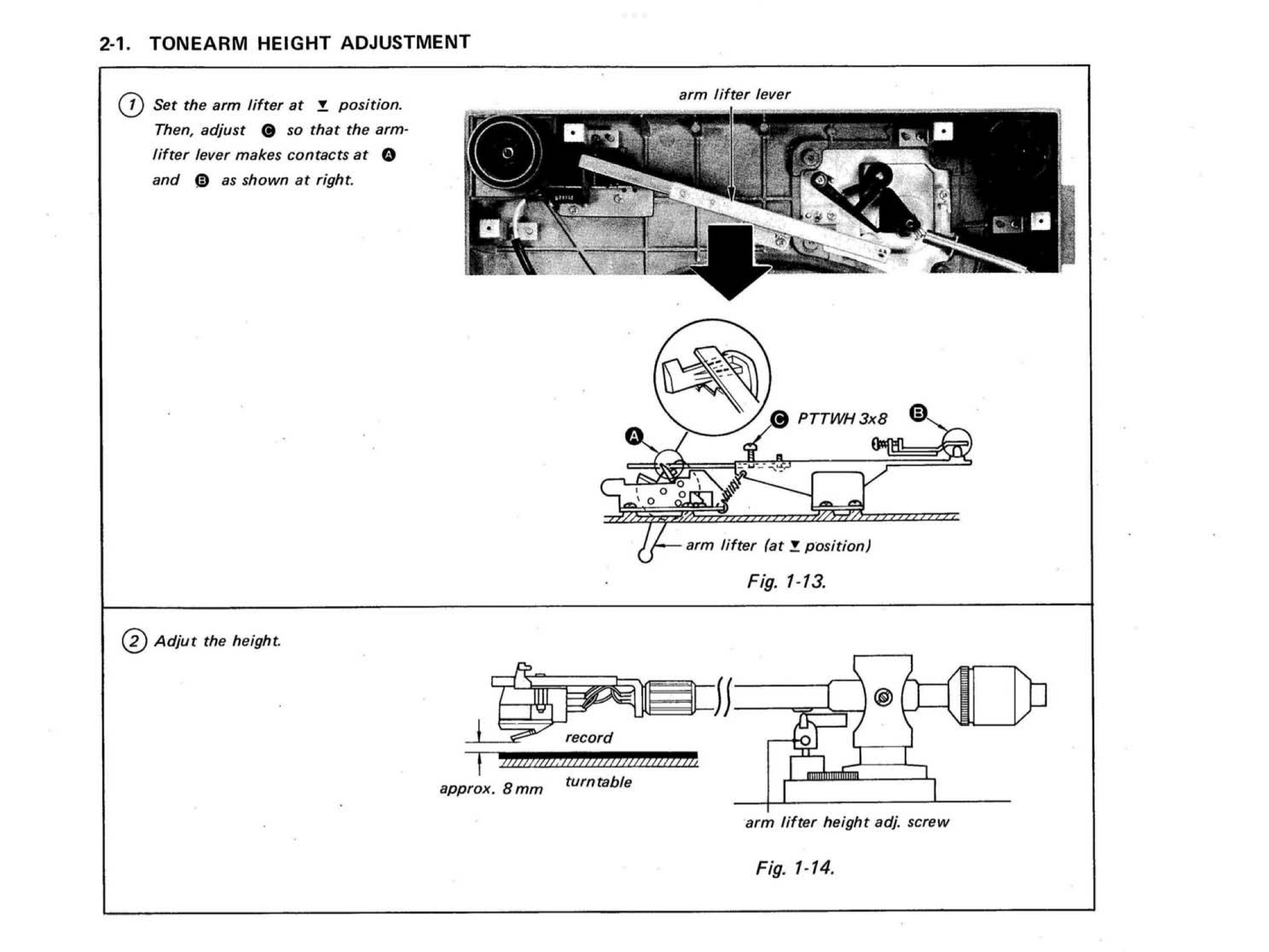

I know this is an old post but if you’re still using a PS-4750, it does have tone arm height adjustment, please see the service manual available at vinylengine .com .

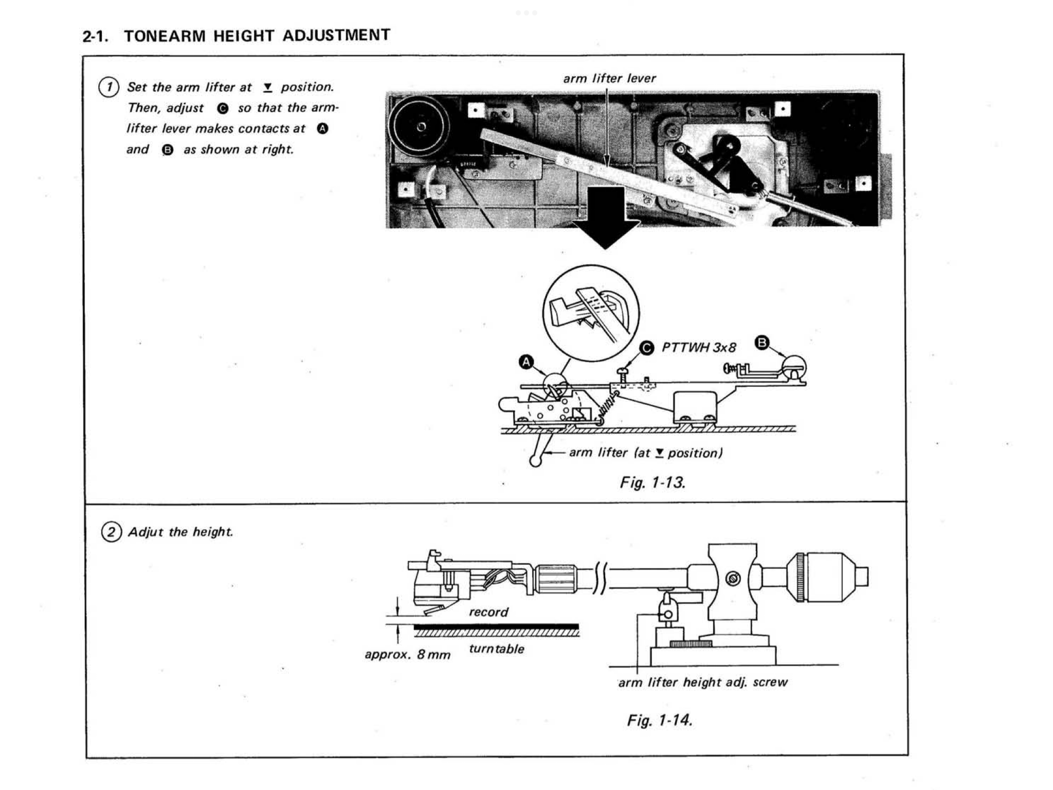

That is an adjustment for the arm lifter; not the same as adjusting tone arm height. To raise/lower the tone arm height the entire gimbal needs to adjust up and down which affects the angle of the stylus to the platter.
That’s an adjustment for arm lift, which does not effect vertical tracking angle. Fact is the turntable’s non-adjustable design only accommodates 15mm height cartridges like the Shure V15V-MR. To accommodate an 18mm cart,like some from Ortofon, requires purchase of a tall headshell, like the Ortofon SH-4, to get proper vertical tracking angle.
