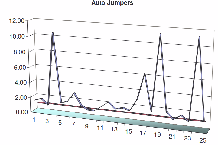

Like nearly all audio snake oil, that first PDF is largely non-sense, based on a shred of truth that has been well known for many decades.
That second PDF is complete non-sense. It says absolutely nothing at all. None of the graphs define what is being measured. It shows numbers, but there are no units at all.
And I thought I was the only one who thought this was BS. I also couldn't understand the points he was making.
