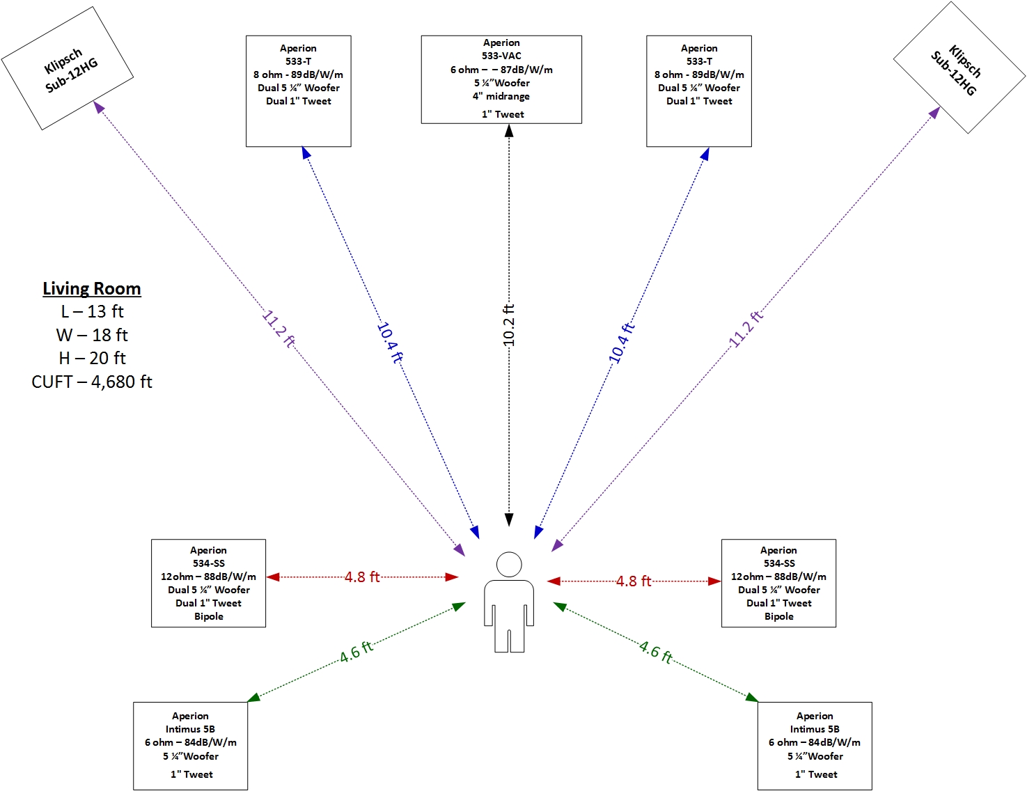

If you are talking about the inverse square law, then when you stated 3dB loss for doubling the distance you must have meant 6dB right? Sorry I am sure that was a typo but we have to get it right.
By the way, Isiberian was talking about dBW, not dB. He may have his own rationale with other things factored in, so I won't comment on his method, or math without knowing his basis and assumptions.
Not a typo, I just woke up. I also corrected my post.
PENG
When you factor in boundary gain, 3db per meter may be overstating it. The problem is that factoring in boundary gain requires measurements and, if you can measure it, then there is no need for the formula. I think the calculators are better than nothing but, frankly, not really very good and a poor substitute for measurements.
Yes, I agree with you, but if one is to state the inverse square law and it is 6 dB. From there, one can factor in room gain and other considerations to fit the specific environment/application. Fair?

Sure but I think an audio enthusiast should be equipped with an SPL meter and digital multimeter. Measurements are far better.
I think factoring room gain and everything else would be difficult because of all of the variables. An SPL meter isn't necessarily expensive, but it does need to be on the correct scale. I find REW works well, if the mic and associated drivers are current but the mic in my laptop takes a dump around 4KHz, comes back around 12KHz +/- 2KHz and craps out again. Works great with the Behringer mic but I bought that because I do AV as a business and the laptop just wouldn't be a credible measurement tool.

Agree, that's why I have a SPL meter, REW, mindsp mic and a $500 Fluke digital multimeter. I have taken my fair share of measurements. For those who don't have any such tools, the dB calculators based on distance are still useful just to be used as rough guideline as long as they factor in room gains, two speaker gains etc, but again as we all know without measurements those are just educated guessimates.
