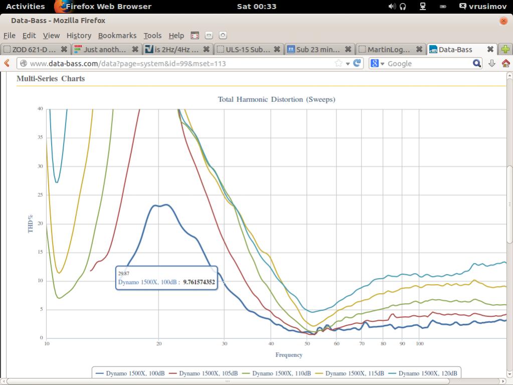

As of last night I'm in the market for a sub and I'm sort of torn between three subs, all Martin Logan. My room size is 18Wx20Lx12H, but one of the walls opens up to the dinning room, so it's a "three-wall room".
The subs are:
Dynamo 1500X -> $1600 (satin finish) / $1900.00 (piano black) -> 650 watts (1300 watts peak) -> 20–200 Hz ±3dB
Dynamo 1000W -> $1000.00 -> 500 watts (1000 watts peak) -> 22–200 Hz ±3dB
Dynamo 700W -> $700.00 -> 300 watts (600 watts peak) -> 24–200 Hz ±3dB
As of today, I would not want to spend more then about $2000.00 for the sub/s. My original plan was to get two of the dynamo 700W to keep it balanced. Then, I decided to do two of the 1000W. Then again, I was thinking to get just one of the 1500X, because it can go down to 20Hz, ...and now I'm just confused :confused: . I'm looking to have nice, tight bass. I'm willing to spend the money, but I don't want to waste money if the difference is going to be marginal... you guys get the idea.
My questions are:
1. Is 2Hz/4Hz difference worth the extra money, will I hear/feel it?
2. Would I be better off getting two 700W's or two 1000W's vs one 1500X?
3. ...should I maybe consider Grotto or Depth from the Reserve ESL Series and not get any of the Dynamo Series subs?
4. ... your suggestions, preferably within the Logan family ;)
Looking at Ricci's results, the 1500X is an absolute no go. The distortion below 30Hz is... sobering, and that is avoiding a more pointed pejorative, given the price of this subwoofer. It might get to 20Hz but it will be a dirty little boy when it gets there. The 100dB sweep just says it all about how much this driver can pushed, which is to say not much at all. If you want a 30Hz subwoofer, then the 1500X is your sub, otherwise, a less than prudent parlay of pecuniary reserves in my opinion. Forgive the caustic nature of my commentary but the tests speak for themselves. Not everything is about how much SPL you can wring out of the can.
Secondly, I would caution you that if you are looking for a perceptible difference in infrasonics, then a good target is extension by at least one octave of bandwidth from where the bottom is currently in your system, i.e. if your current extension is 20Hz, then I would say that 10Hz would be really noticeable. This is a difference that is likely not to disappoint you after having put down an appreciable amount of billage. 4 Hz might be noticeable, but you are up against the typical greater than 12 dB/octave roll off of protected commercial/ID subs, not to mention where the sub actually begins to roll off. Can't have too many destroyed drivers coming back for replacement. I would stay away from the Dynamo series, point blank.
If a great ported sub is an option sure it's a better choice, but if it isn't then 1500X is good enough to complete a great sound system. It is certainly not a no go.

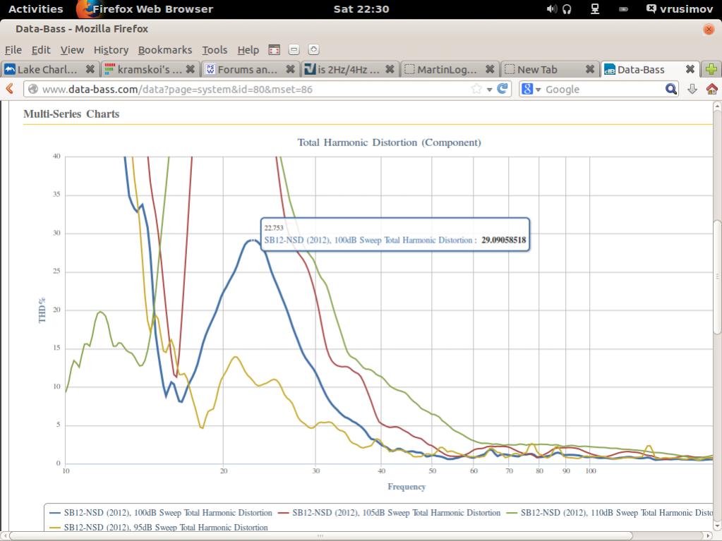

That's the graph for SB12, not the SB13. SB13 has more than twice the power and it's almost 3 times more expensive the SB12. I've been looking for a data sheet on SB13, but couldn't find anything.
C
copmagnet82
actually, SVS has it posted, too, I don't know how I missed it :rolleyes:
Sorry my friend but 20Hz is a no go with that design. I do suppose you will have additional slam at ~ 40 and 60 Hz as a THD benefit. You would not necessarily need a vented sub to have good output at and below 20Hz. Not even a commercial one. Good enough is simply not good enough at $1600. For the original poster who is looking for more extension, at $600-900 this makes little sense to me.

Hardly any sealed sub is going to give you clean 20 hz output. I doubt the SB13 could do that a whole lot better than the ML sub. If you want clean 20 Hz, you will need something like a PB13 Ultra.
Yes, you might be correct. The SB12 is worse than the ML @ 100dB but it is a smaller driver, although it is not a SB13, which still only uses a 13.5 inch driver. You simply can't get to those frequencies with drivers so small. Sd works against you no matter the xmax. Think single, high xmax 18 - 21" and dual 15" sealed configurations.
That said, I would be surprised if the SB13Ultra was not as good or better than the ML, even with the smaller driver.
*Looking at the HTS data, the SB13 Ultra is indeed better, with 8.3% THD at 107dB. It will be cleaner around 100dB. At the same price point, I like SVS.
