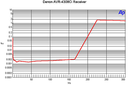

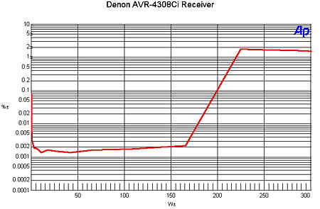

I agree with you on that to a point, but not to the point when you are talking about numbers as low as 0.002% to 0.01% right up to and past the rated output, such as that of the Denon AVR-4308CI. You can also look at the harmonic spectrum (I cannot post them due to copy right..),the higher order harmonics are as good as amps that you probably respect, including NAD, Anthem, Arcam, among others. The individual components cannot be greater than the sum!! My 4308 does sound as good as my separate components, and it does use negative feedback.
https://www.soundandvision.com/content/denon-avr-4308ci-av-receiver-measurements
I think you did not read the article I posted. If you did you would see that claim is incorrect.
What claim? I did read the articles you posted, though not in detail and you posted a few so I might have missed one.
