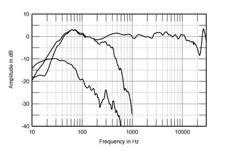

The opposite is more true actually. The Matrix series was very "analytical" due mostly to the overall tuning with a slight excess of energy in the 3-6kHz region, both on and off axis. The Stereophile review explains...https://www.stereophile.com/floorloudspeakers/506/index.html
I was looking for and FR on those, but could not find one. That is exactly how that series of speakers sounded to me. However it is a pretty good FR.
The OP is talking about the series 1 which were sealed and not ported.
Mid and HF would be identical on all the B &W speakers that had that same head unit.
Of note is that there is bass ripple. B & W do seem to do their bass alignments like that and that is actually my biggest criticism. I heard a a recent B & W at Hi Fi Sound in Minneapolis and they are still doing it. I really dislike that alignment. The only B & W speaker I can be certain does not have it are the 800 D3s, as I have measured them.
The slight rise in energy is associated with cone breakup as the speakers start to beam in that area.
But the OP almost certainly has come across a better speaker then he had had before.
I also owned a pair for a while, and they were a very good speakers in their day.
I think it's from the tweeter, not the mid, because the off-axis plots show beaming down at 2kHz, and the waterfall is very clean through that crossover region. The tweeter's lobe is also very broad in that 3-6kHz region, compounding the issue a bit, depending on room dimensions and acoustics. Fwiw, my 801FS's shared this trait too.
