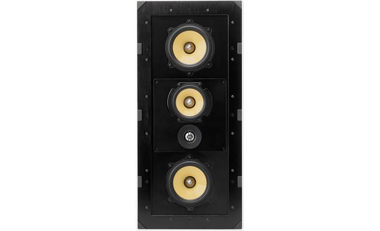

Focal looks to be a good option -- at Crutchfield
PSB inwall -- at Crutchfield
