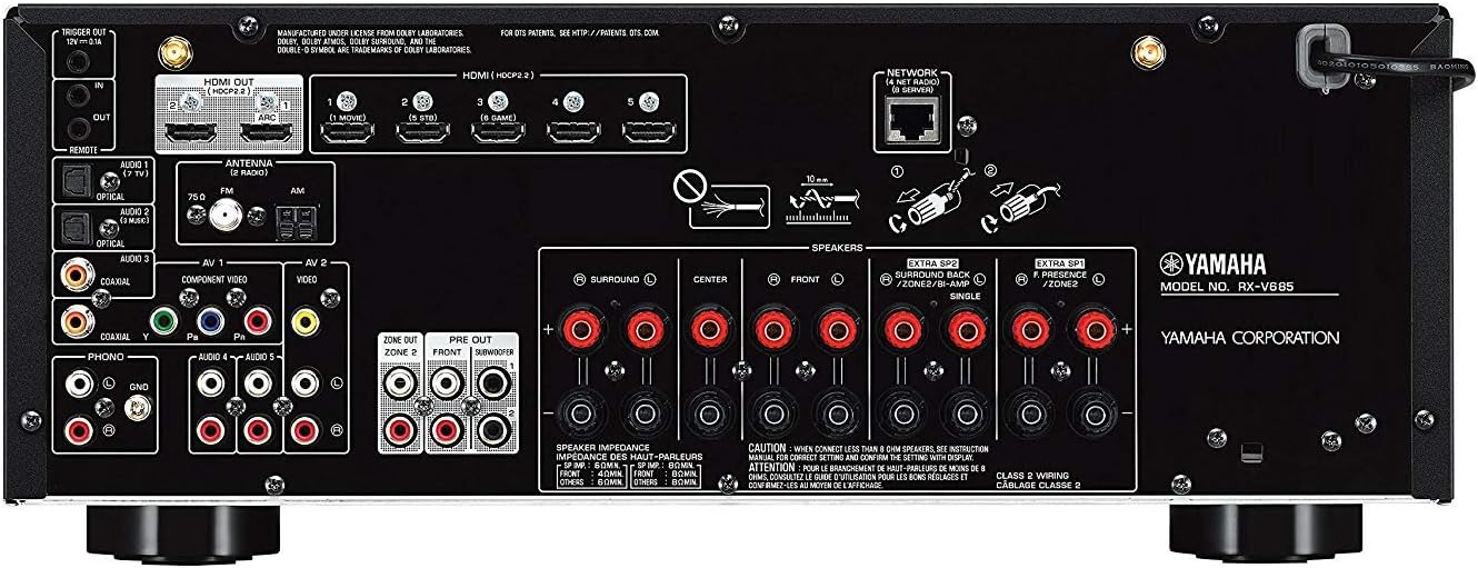

Your Yamaha RX-V685 can accept an external amp only for the front Left & Right speakers. In the photo, see where it says PRE OUT Front. But adding extra power won't address the problems with sound from ceiling speakers.

Your Yamaha RX-V685 can accept an external amp only for the front Left & Right speakers. In the photo, see where it says PRE OUT Front. But adding extra power won't address the problems with sound from ceiling speakers.View attachment 66486

What does the "pre out" mean ?

Pre-out is exactly what Swerd said: preamplifier output, labeled as pre out.

Adding two pairs of speakers to a single output is likely to strain the receiver. Adding an amplifier with enough channels for the number of speakers you want via the mentioned pre out will work.
