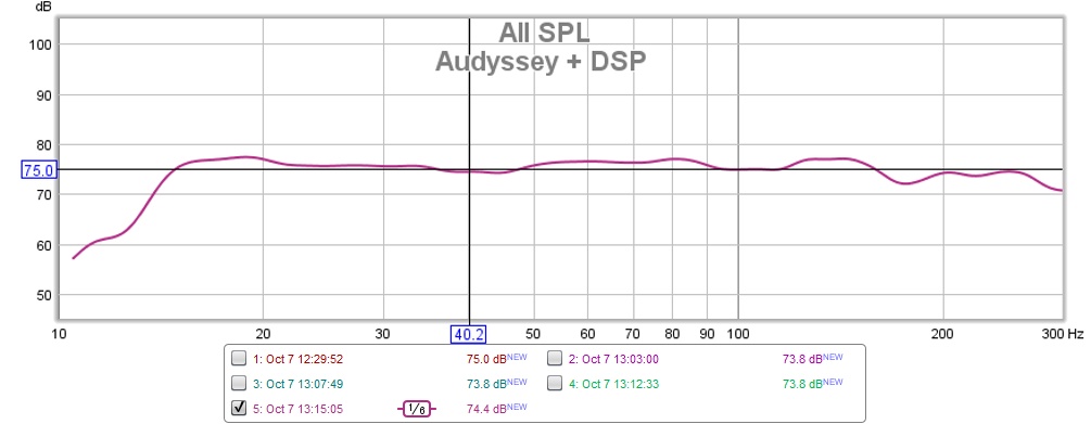

I have a flat response down to 15hz with a pair of Hsu VTF -3 MK5 HP's. Great bang for your buck and it's legit clean bass.
*Edit: Price in the link is for 2 of them.

That's an awesome room response curve. For the OP, this shows that with some tinkering you can achieve some remarkably fine audio quality in the lower registers along with tremendous thumping ability. No need to screw the music to get the thump. Pogre has them both. Whatever he says, I'd do that for subwoofers.
