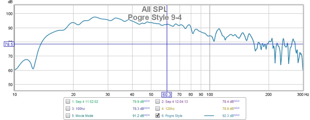

Sweep it at 75 and whatever loudness you are willing to endure with earplugs for a few seconds.
Can it be overlapped afterwards for differences to be obvious?
Oh yeah. I can do an overlay. I've done 15-300 hz sweeps playing with my house curve and was hitting like 95db unintentionally with no problem.
This is from last month. It's the house curve I was playing with. I've recalibrated since, but I always do these sweeps with the volume set at -25. This is in 2 port open, eq2 mode (more headroom mode) and they never even broke a sweat.
Show off those tight curves! :eek: :D:D.
Does it look similar at 75 dB?

I guess your two graphs shows two different conditions now that I look at it again.
The first one is with no eq or level adjustments at all. That last one is a house curve I was playing with. I was surprised it was 95db when I measured. That's what I meant when I said I hit it accidentally.
Have you tried to measure a maximum output sweep? The Hsu subs can take it, their filters will protect the drivers. You should see what they can do! That is probably something you will not want the wife around for, however.
Pogre
Pogre
I never did. When I get back home I might. I'm at my sister's this weekend. I'm officially curious now. I know I can hit 105dB with no problem and it sounds and measures the same. That last 10 tho... we'll see.
