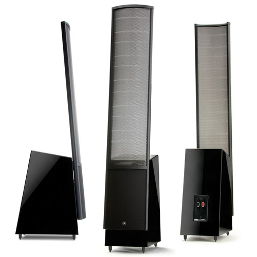

I'm redoing my whole audio setup (2.1) for my TV, which is exciting and terrifying at the same time. I'm going to be using the Emotiva UMC-1 for my processor, an Emotiva UPA-2 for the amp, and an SVS sub.
But that won't get me too terribly far without some speakers, as you might have suspected. After a lot of searching, I narrowed my choices down to the RBH SX 61-SE/Rs and the Martin Logan EM-ESLs. Honestly, I really have no idea where to start in comparing them. I'm in a mid-sized room, so I'm kind of worried that the 61-SE/Rs won't pump out enough sound since it's just the single tweeter and woofer. But on the other hand, I'm worried that the Martin Logans have more marketing built into them than high-end tech. I'm also worried that the woofer in the MLs isn't up to the task. And how does the electrostatic panel in that thing compare to ML's top-end models?
So yes, I'm very confused. I guess I'm just looking for the pros and cons of each of these choices.

Hola and welcome to the forum.
I must preface this by letting you know I have not heard either of your speaker choices, and that speaker choice is highly subjective anyway. It's only your ears that ultimately matter to your brain. And unfortunately, you won't really know until you audition them in your room.
In addition to considering the basics such as power requirements and spl limits, the choices you have are quite different in regards to room placement. Given your small room, this is an important consideration. The RBHs will require less real estate than the dipole MLs. To perform their best, the ML will need enough room from the back wall to get the desired delay for the sound radiated to the rear. Not enough (i.e. too close) and it smears the image. Can your room accomodate the MLs placed well out from back walls?
In their favor, since you are doing 2.1, the added ambience of the MLs may work very well for you, making your room seem larger than it is, with more ambient sound than the RBH.
I would probably audition the RBH first. I use similar speakers in a smaller, well damped room in a near/mid field type listening arrangement, heavy toe-in, cross-fire type orientation, and the sweet spot spans the whole back half of the room; the ceter image is so solid, folks constantly ask where the center channel speaker is hidden. I use dipoles in a much larger, more lively, reflective room, where they have the room to really work their magic.
So consider the room, as the speaker/room aspect is 90% of the equation.

Okay, a few more details:
- As far as placement options go, I can place the MLs as much as 2 or 3 feet from the wall, but that's about it.
- One of my hangups is that the MLs are basically their least expensive electrostatic model and I'm worried that it's going to have some major compromises that I'm incurring solely to have a cool-looking speaker. Meanwhile, the SX-61 SE/Rs use the same midrange and tweeter as the apparently incredible T30-LSE.
- Another hangup is pettier - I like the pretension of owning something you can't find at Best Buy (even if it's in the Magnolia center.) That's a lesser point, of course.
- Finally, would a tower speaker really be that much better, considering I'm using a subwoofer? And considering that both are around the same price, it would make sense for the bookshelf to be better than the floorstanding speaker... well, all other things equal, right? I'm just not sure what the inherent advantages would be.

We had been RBH dealers in the past (even helped an AH forum member with a pair of T30LSE that OP mentioned) and have brought in some Martin Logan pieces recently to sample as well as spent quite some time with them at CEDIA.
It's an incredibly unique sounding speaker. It will absolutely require careful positioning, but the payoff is one of the most incredible sounding speakers. Their demo at CEDIA, granted it was their new $10K/pr models, was fabulous and really stood out as, IMO, the best audio demo there. And yes, I listend to the Synthesis & $60K ID dARTS demos - For the record, I much prefered the dARTS system over the JBL, but that's for another thread.
I would do the Martin Logans in a heartbeat over the alternative you listed. Not that the RBH is bad... it's a great company run by pationate people. But the Martin Logan product is, IMO, pretty special sounding. The big thing to pay attention to is PLACEMENT! If you can fiddle with that until it's right... you'll love them.

Just a thought....you will need an AC outlet near each speaker too.
They do sound best 3ft off the front wall and at least 4ft from the sides.

Three feet from the back I can definitely do. Four feet on each side... not so much. They won't be by a wall, but there are a couple pieces of furniture (not gigantic pieces, though) in the way. AC outlets aren't an issue.

Your choices are both worthy of consideration, and the gear you have is perfectly capable. Regarding these two speaker choices, it's still kind of apples to oranges comparison. Differences go beyond tower/bookshelf; you're comparing direct radiators to dipoles.
Think of it this way: properly set up, the dipoles can make your room seem considerably larger than it actually is, giving you a middle-of-the-house type perspective on the sound stage, a large and clear, but somewhat distant window into the music. This could be exactly what you like, and work well in a small/med sized room, and compensate for the fact you're only using two channels. Added ambience, properly rendered, is good. You will have less placement flexibility, but it may be worth the compromise.
The direct radiators, on the other hand, may not provide the enhanced sense of space, but you'll be 'on the conductors stand' instead of a few rows back in the audience. Imaging may be pinpoint accurate left to right. You will have relateively greater flexibility regarding room placement, i.e. closer to rear walls, possibly wider spacing left to right, and more toe-in flexibility. You'll likely have to focus more on room acoustics (placement, room treatments, decor) to get the same sonic depth of field as the dipoles, but it can be achieved.
Any chance of in-home auditions of your choices? It's the only way to know which speaker works best for you. And I'd bet either of your choices will yield very satisfying results, if implemented properly.
I'm not helping you narrow this down, am I? What can I say, you've got a rich man's dilemma.

That's only on the models that use the onboard sub amp. The ESL that I think the OP is referring to is non-active.
Doesn't sound like a problem.

I think my biggest concerns with the Martin Logan are a fear of snake oil, and I'm also a little worried about that low-frequency driver... my concern is that it's going to be kinda crappy compared to the panel, and it's not like my sub can take over the whole range that that thing covers.
And with the RBH, my perception is that "well, this is a smaller version of the T30-LSE, so in a smaller or medium-sized room and coupled with a sub, it'll be the best speaker ever." Which I know is a little silly to expect, but yeah.

I actually don't think you need to worry about distance from side walls. Dipoles don't radiate very much sound in those directions, or vertically either, unlike most speakers.
But I would not do anything less than 5ft from the back wall.
