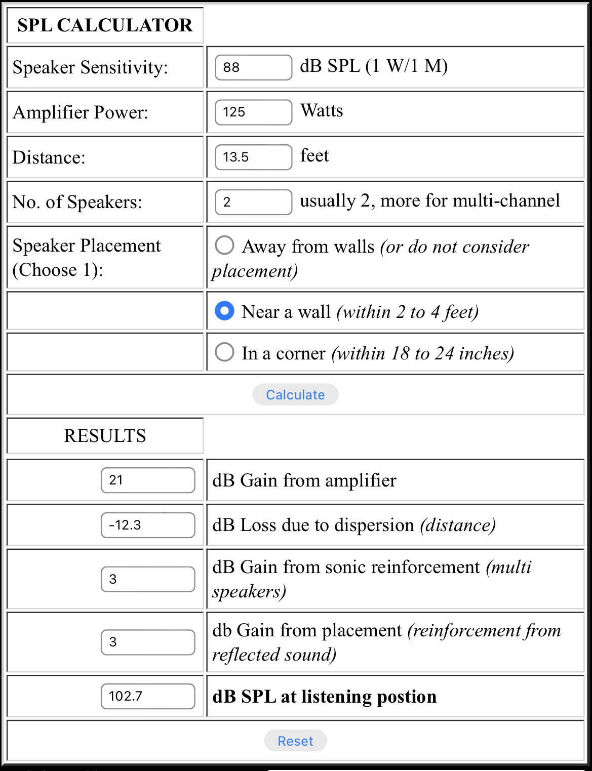

The results show if you listen to levels close to reference, the AVR-X4300H won't have enough juice for music or movie contents that have high dynamic peaks. If your maximum spl required is, say 10 dB below reference, then you will be fine and in that case adding an amp is still beneficial, but I doubt you will have audible benefits.
Note that reference level is 85 dB average, 105 dB maximum (highest peaks) from just one speaker at you mlp.

Thanks PENG. I do normally listen to movies at that -7 to 0 mark on the x4300h (10-20 times a year). in addition, music at the same level lets say 20-30 times a year. its not more often because i like my hearing and more importantly i need to be respectful of the neighborhood sometimes :cool:.
So if i understand you right it could be one of two things?
1. I could be pushing past the SVS ultras limits in a room as large as mine. (As some have mentioned)
2. The ultras can handle it, but I'm clipping my receiver to get there.

That sounds about right but I believe 2 is much more likely. In fact if you crank it up to 0 or even near 0, you should get an external fan to help cool the unit.

I forgot one factor, your level trim settings!! Please check to see what they are set to after running Audyssey. If they are within a dB or so to 0 then I standby my educated guess that the AVR will clip during the highest peaks found in some movies. If not, I would like to know the settings in order to update my guess.

Excellent point! I could not find any bench measurements on the SVS Ultra Towers, let alone the rarely done measurements that would relate to your concerns.
My educated guess on the big towers are based on the following known facts:
- They are 3.5 way
- 2X 8" woofers
- 2X6.5" mid drivers
- Reviews/measurements on the likely similar design but much smaller Ultra Book shelf speaker
So I guess:
- this so called nominal 8 ohm impedance would be more like 6 ohm on average practically speaking
- distortions and linearity in the 95-105 dB range you mentioned measured at 1 m should not be an issue
Now on the linearity part, take a look of ASR measurements on the small Ultra bookshelf:
It managed only 0.5 dB loss at 112 dB @ 1 meter, that would be about a 100 dB @ 4 meter, and that is almost the OP's mlp of 14.5 ft (4.4 meters). The SVS Ultra Tower has much more and bigger drivers so it is reasonable to assume it should be able to produce at least 3, likely 6 dB more under the same condition.
All are +- 1 dB
