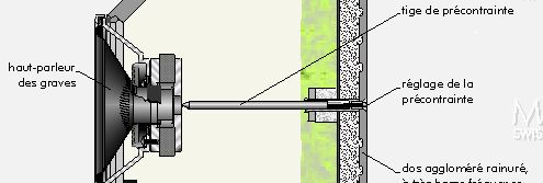

I love all the great information. About cabinet bracing, is anyone familiar with the Swiss designer and builder Jean Maurer? His line of tower speakers JM 370e uses an interesting internal cabinet brace of attaching a rod from the back plate of the woofer to the back panel. No other internal bracing installed. The site is all in french but it's called "tige de precontrainte" = prestressing rod. Why isn't this used by other designers? Pro's and con's?
This sort of design is used by other speaker manufacturers like in Monitor Audio's Platinum series, among others. The reason why it's not done more often is cost versus benefit. It probably isn't all that beneficial, a lot of effort for a low return.
