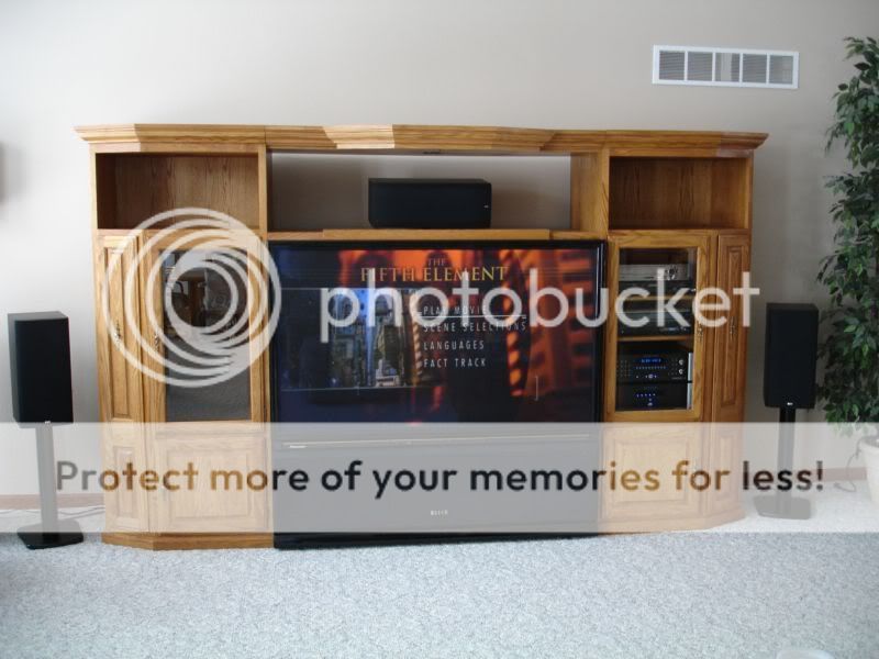

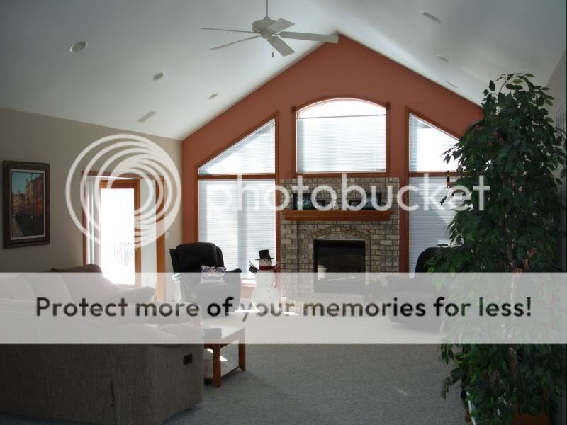

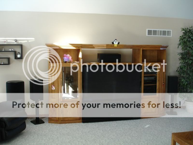

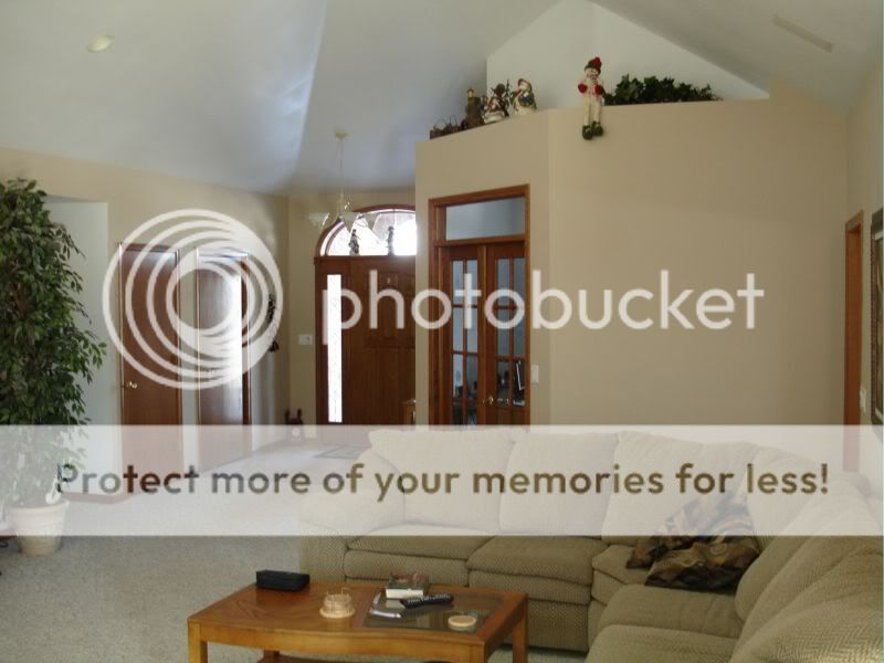

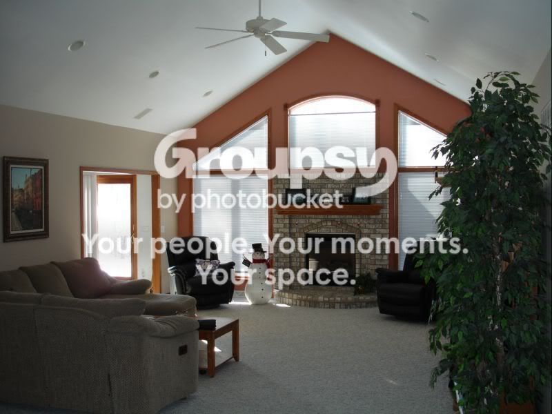

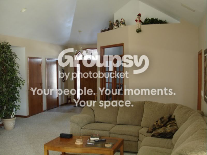

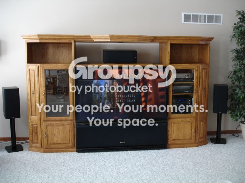

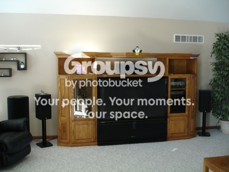

I don't have any room treatments and I'm sure if they would or wouldn't help. I think my room is ok just like it is, but there's always room for improvement. Remember, I have a loving wife of 16+ years to deal with...
Here are a few photos of my room I took recently:
New Emo gear:
I hope this shows you well enough what the room is like. The large opening in the first pic is to my dining room.
Sheep
Sheep
First, reduce the toe-in on the speakers. Second, those windows are going to reflect like crazy. See if your spouse will allow thick, heavy drapes.
Your room will benefit from treatments. You can get treatments that match your decor, see if the misses will allow that, too. Honestly I'm surprised she allowed the cylinder subwoofer. :D
And LOL @ the "Emo gear". I totally read that wrong the first time :D\

have you varied speaker placement away from that console? Maybe you're running into some SBIR?
New Emo gear:
I agree, those speakers are much too close to the console. They need moving forward of it. The space does look as it it would be plenty live. I do think a space that large would benefit from heftier speakers. A sub helps in the last octave, but the power is really in the 60 Hz to 2000 KHz range. That mid woofer is going to be plenty stressed in that space. Its the old question, "Do speakers have to be large? No, but it REALLY helps."

Looking at your setup, I see a set of Studio 40's or 60's and a CC-690 in your future.... perfect layout for it....

I'm going to answer this post, but noting you other guys are all in agreement about my speaker placement.
This issue HAS been on my mind, but I've been too lazy to make changes. I've been lazy because I HATE that entertainment center. It's about 11 years old and I'm sick of looking at it. Two weeks ago, I almost pulled the trigger on a new Mits 73" DLP, but I changed my mind. I have an outstanding idea for a new entertainment system (built by me) that my wife loves as well. For a million reasons I dropped the issue and purchased the "Emo gear". ;) In other words, I ran out of gas with my current setup... I'll end that tomorrow.
The reason the speakers are toed in so much (actually on axis with my sweet spot) is because that's what it took to get them to image properly. I think they're too far apart. They are about 12' apart and 15' away from me in my sweet spot. I also don't think they sound harsh or bright at all. The Emo gear has actually toned them down just a small bit from my previous Sony ES receiver as well.
The speakers are close the the cabinets, yes, but the baffles are slightly in front of the corner of the angle on the cabinets. I did a lot of listening with the speakers farther away and I didn't think the sound changed at all when moving closer and closer to the cabinets. I was however dealing with the imaging at the time as well, so there might be something there. I'll do some moving and testing tomorrow.
Drapes? No way! Believe this or not, my wife and I have NEVER owned drapes; not in any of our 3 homes we've owned so far. Not our style and I can assure you that the wife will not go for drapes to satisfy my audio needs. I've never considered the room all that reflective, but I do suppose those aluminum blinds are very reflective.
I can't tell you why, but at odd times my wife is just ok with things. Like when I wanted to buy a new TV a couple of weeks ago, she was all for it. My wife is a cheap ***. I'm the one who spends money like water. I can't explain why she never said anything about that SVS sub. I told her I wanted it, I showed it to her, she rolled her eyes and said something to the affect of: "Why do you need that?", and I bought it. Strange eh? She's never commented about it good or bad. I don't know. I could learn everything there is know about audio and teach it to every man on the planet long before I could explain ANY logic regarding women. FACT! :rolleyes:
I think I'll play with the toe and placement of the B&W's a bit. They've been like that for a few years now. Maybe I'll feel differently about how they sound with less toe (or off axis if you will).
