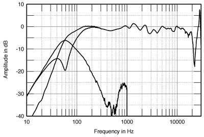

That is hard to tell. Do you know the model of your PSB speakers or know the specs of them.? I suspect you have PSB alpha speakers circa 2005, in which case this is the FR.
Normally if you do what you say, then you normally bring in a sub at a frequency of of F3 + 50%. So if those are your speakers, their F3 is 65 Hz and then you would shelve the sub in somewhere between 80 and 100 Hz, and then experiment from there. How even the response becomes is difficult to predict. It certainly could sound very good, but on the other hand it may not. There would be an element of luck involved.
The speakers are PSB Image B-25. Specs say they go down to 45hz +/- 3db. The SVS tool suggests setting a crossover of 60hz in a non-bass managed system (and recommends their own 2000 and 3000 series subs).
