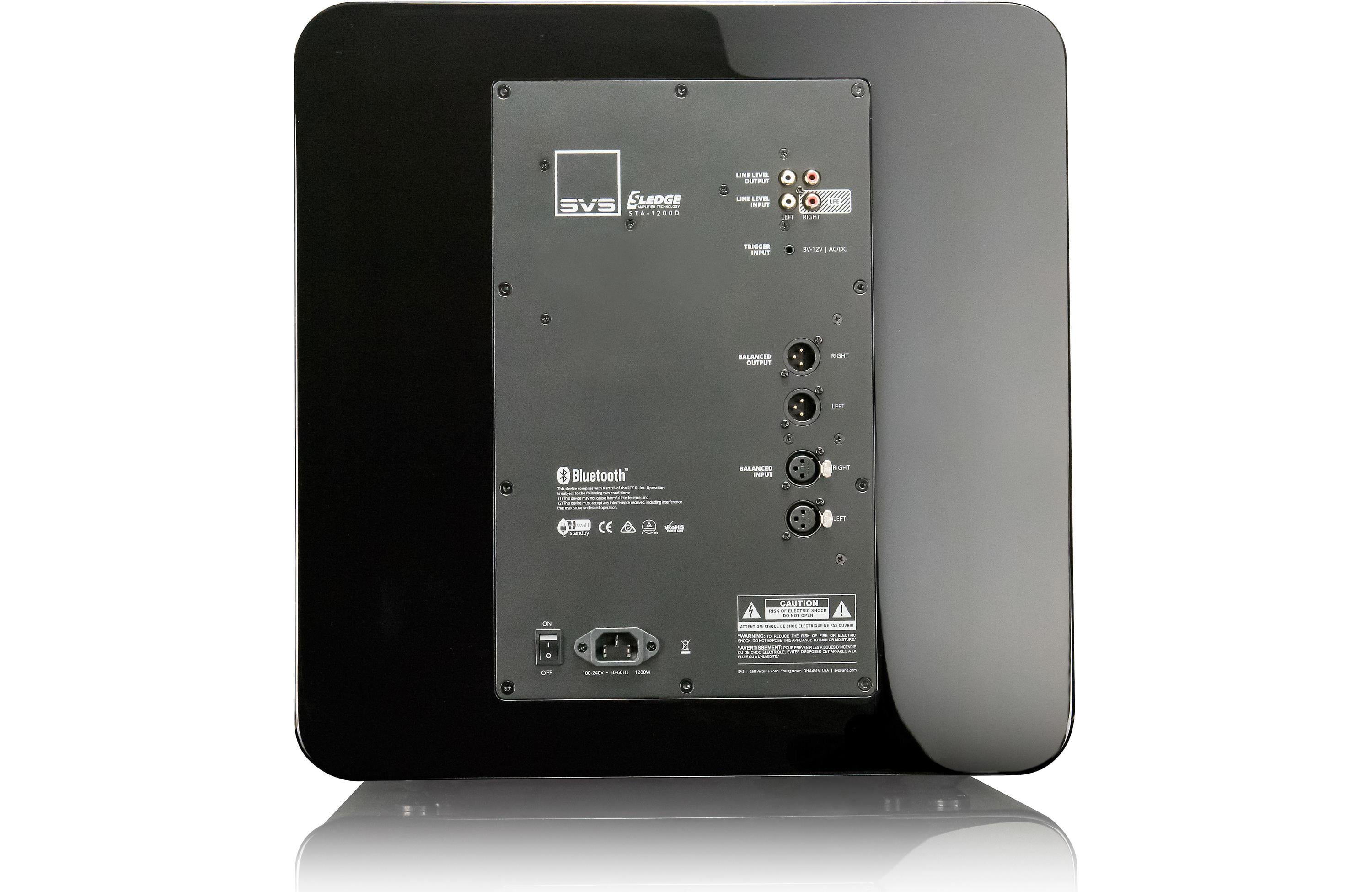

I had an issue with my SB4000 staying on all the time. It seemed to be picking signal up from somewhere, so I bought another trigger manage the sub. Previously, I was not using the trigger and it was never an issue. At first it didn't seem to be working, so I went back behind and pulled the triggers to swap 1 and 2 and I arced on the chassis of the XPA-5 because I was dumb and forgot to turn it off. Now the trigger does not work at all on my amp. I tried trigger 1 and 2 on the sub and both work, so it would seem to be an issue on the amp's trigger. The amp works fine, just no trigger.

The photos I found show that the sub can be operated with BT- is that enabled, or DISabled?
Yes, according to the spec, it can be controlled by BT from Apple and Android devices. However I think a remote switch would be more convenient and quicker.

My question was to to the OP and can't be answered by anyone utside of his place. If BT was enabled, then is would be possible for it to turn on. What I didn't see is auto turn on with signal and that would be another possible cause if it actually had it. As a solution, the remote switch would be best.

Read the first two sentences in the post. The sub was on constantly and he thought that it was picking up a signal from somewhere. That implies auto turn-on. Still, I would investigate further. Maybe a bad cable was causing some noise? Auto turn-on with SVS subs tends to be pretty reliable (much more than with my previous Klipsch). I can understand the desire not to have to add another remote to the power on sequence. A programmable remote could help there.
I use the app to control the sub, but I am not sure it specifically has an "on and off" function, it is basically used for parameter control.
The trigger that got toasted is on my main amp, not the sub. The amp has no BT control. The SVS is working fine with the trigger. Still a similar answer, I don't want to ship the amp back for that to be repaired. I'll give a smart plug a try.

It implies that but there's no switch to enable auto turn-on on the rear panel. It may have it, but I wasn't going to search for info that could have been included.

I wasn't asking about the amp and I saw that its trigger fried- the sub has BT on the label. Since the sub has that capability, does the app include On/Off?

No auto turn-on that I can see. I only see power on/off and trigger input. Without the trigger I would assume that the sub is always on. Looks like it's either using the app or a programmable/remote switch.

Yes, the sub has BT and I use the app for it, but only for settings. I do not use the app for the rest of the system. Looking at the app, which is updated regularly by SVS, there are no on/off commands. I was using signal sense and it had not been an issue for years until I moved to this house. I am OK with the trigger for now.
The sub is working fine :) It is my XPA-5's trigger that bit it. Definitely an accident, but my fault. The SVS does have signal sense, that is the default when not using the trigger.
I am using the balanced input as well, same as previously, so I would not expect noise on the line keeping it active.
