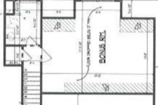

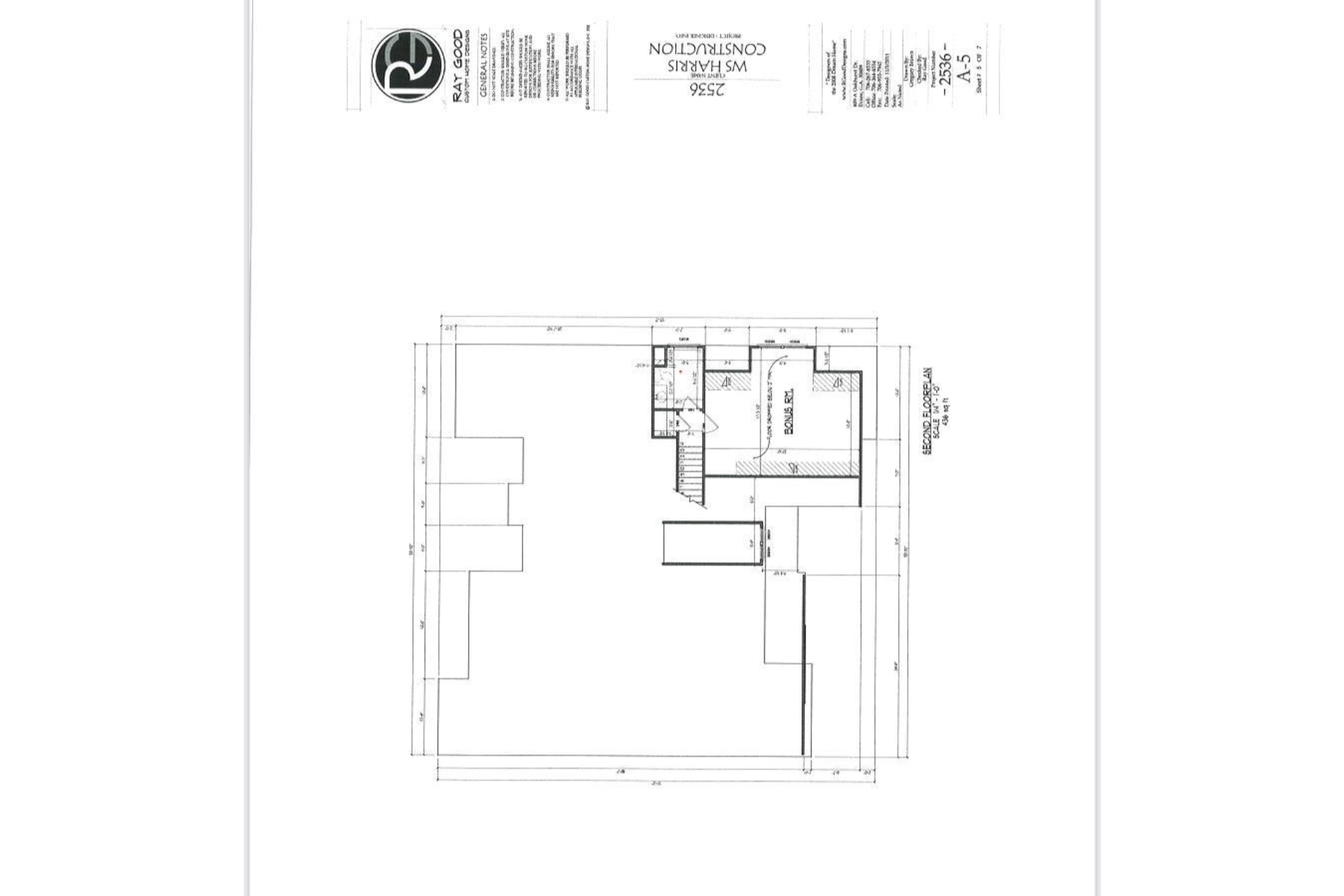

Hey fellas, finally found a diagram, I’m actually putting a sectional upstairs, so that will be one row of seating, my wife also has softened her stance on floor standers up front so that won’t be an issue, so I just got to go in walls for surrounds and rears or I just read in in one of your guys that I may need to go 5:2:4, I m actually open to either tv or projector, thanks again for such great advice guys!!
Thanks but the drawing resolution for the Bonus Room is too small. I've tried to manipulate it, but no joy.
I see no cable exit positions (from the walls or Atmos locations in the ceiling) marked, dimensions, nor seating locations. We only need the Bonus Room like I have above. Can you make it legible and reup it?
The window box is larger than I expected at over 1/3 of the room length (over 12 feet!) so based on that, your sectional is forward of it towards the TV wall. 2/3 of the space is not for HT (Home Theater).

I'm really trying to help you out, but without these details, I'm just guessing.
