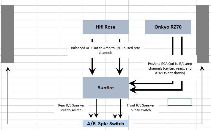

I'm working towards integrating a clean two channel solution into my system. I'm about to order a HiFi Rose streamer. I have two free channels on my separate amp that I can run XLR to from the HiFi Rose. However, I need to be able to switch the speakers between the two channel and HT setups. While I think this should be easy and straightforward, it's not so much so. Most switches have one input and two outputs for two sets of speakers. My need is in reverse. The second obstacle is finding a switch to handle the 200w/channel from the amp.
I played around with my buddy's EverSolo and I simply have zero confidence that running analog through my receiver into bypass/pure mode is in fact that, because when i did that vs. running direct and just swapping my speaker cables for a clean path completely bypassing the receiver, it was virtually night and day.
My thought to maintain the cleanest signal path would be to have the speaker cables from the R/L HT side and the speaker cables from R/L of the other two free channels connect to the A/B switch and have a set of speaker cables then run to my speakers so I could select the "input" rather than the output. I just can't seem to get past the 100w limitation of most switches, however. I appreciate any thoughts. Thanks.

That is a lot of power for a speaker switch and I think you will burn it out. It will also create a lot of back EMF if you switch it at power.
Some of those Ever Solo amps look pretty beefy.
I am told here again and again that receiver amps are fine. I have always doubted that, and you are giving my suspicions some confirmation.
I would never ever use a receiver to power my speakers and that is one of many reasons I don't own one
What I would do is get a two channel power up and connect it to the preouts of your receiver, and when you want two channel just set the receiver to stereo and you can decide whether you want to use the sub, which I would recommend.

Dumb question. Why not use XLR for the 2 channel and rca for HT. Then use the toggle on the back of the amp to swap them out? Maybe I am misunderstanding.

Okay thanks but one, I'm not using my receiver for power. Two, I'm using just one set of speakers and there is not a clean path going through my receiver. That part is obvious by my testing as I stated. I don't need another amp. I have two free channels already. I need a way to switch the speakers over from front R/L which is my HT setup and the rear R/L which is free and which I have the streamer hooked up to.
I need two different paths to the same set of speakers... that I can switch in between.

Ahh. So does the sunfire have toggles to switch between xlr and rca? If so what I am saying will work as you use the rca going to l/r from the onkyo and the xlr from the rose. Then you switch the toggles on the back of the amp when switching devices you want to use. I did this for a short time with one of my ATI amps so I know it works.

Unfortunately no... no toggles. That would certainly be a no-brainer. I didn't even know that existed. Damn!

I wonder if the Sunfire would recognize which inputs are being used? I mean if I have the receiver off which would be plugged into the RCA's, would it then only recognize the XLR connections from the ROSE if powered that up? I guess "toggle" with out a toggle?

That is true. I was scared to even suggest anything where both could be live. I found this on Amazon https://www.amazon.com/SOLUPEAK-P2-Amplifier-Switcher-Loudspeaker/dp/B093GSS8P7 which look like what you need. Just won't comment on quality.

I was actually looking at that today. I didn’t see an amp max listed. Some of the other ones they sell seem to have that 100w max. It does say “high current” so maybe.
It is a really, really bad idea to switch power amps between one set of speakers. You usually end up connecting the outputs of both amps together and blowing up the whole works.

Using break before make switching is the only way to do this and only if there's no possibility of connecting the outputs in the process.
Power handling is a big reason I would avoid anything on the market for this, although I have used Niles switchers and they work fine. The problem is that Niles was sold and the morons at the top don't know why Niles products were needed and why those of us in the custom integration industry are so PO'd that we can't get them.
