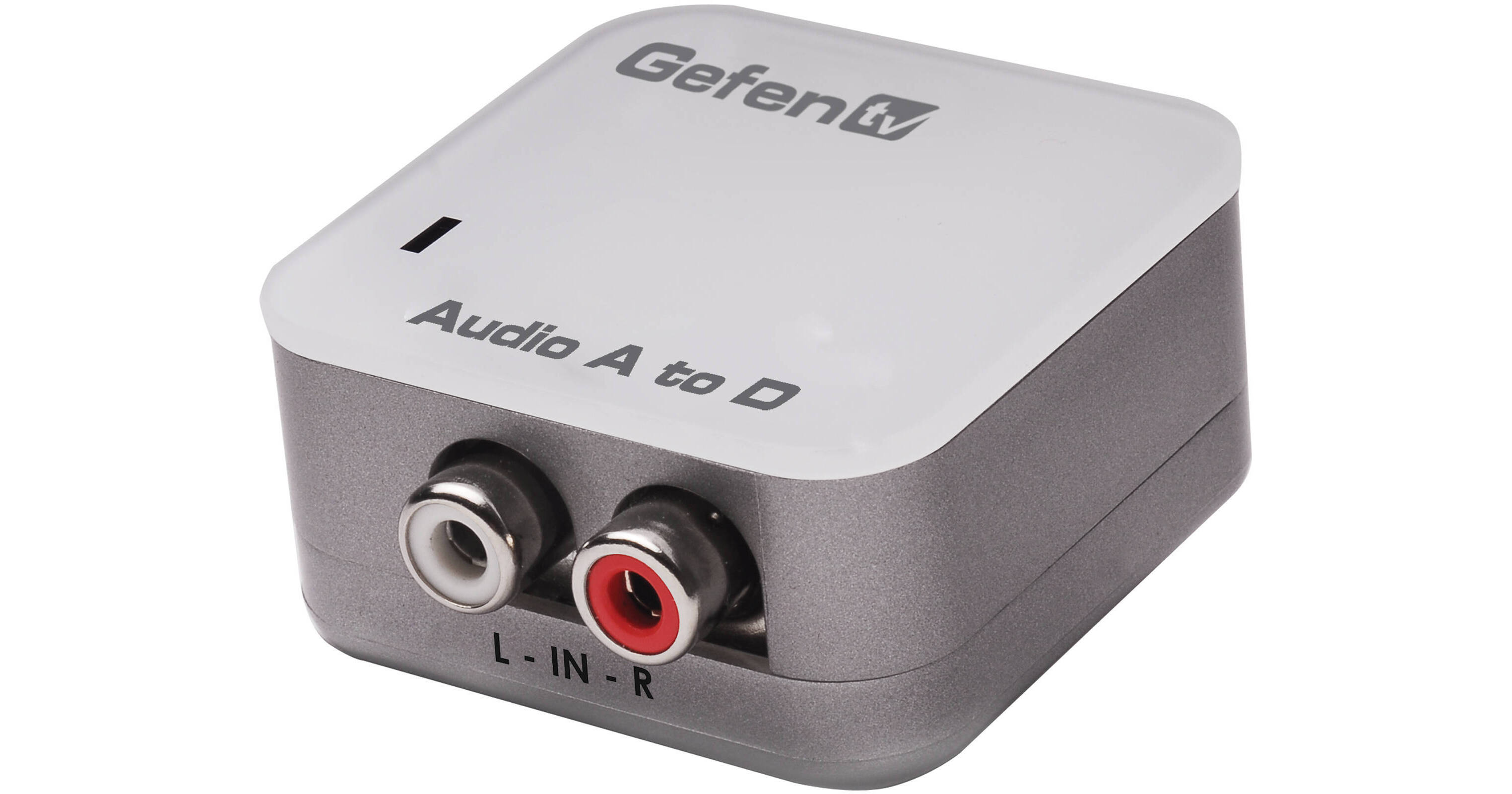

I have another idea Last time I watch some channel about audio and subject was to improve audio signal for better sound quality using HDMI audio extractor
And questions is what if I connect cassette deck player with RCA to HDMI audio extractor and from audio extractor cable hdmi to amplituner
So from amplifier to audio extractor will be hdmi cable from audio extractor to cassette deck will be RCA
What do you guys think?
I think that you still have a lot of concepts that you aren't wrapping your head around. You are also reading some information that is well out of date. There are some pieces of information you've presented that are mixing data types up as well, which is not appropriate.
A HDMI audio extractor EXTRACTS audio from a HDMI source and gives you digital 5.1 audio for a speaker bar or older AV receiver which does not have a HDMI connection on it. Likewise, it can give you analog audio OUT to a receiver or system that needs stereo audio. It doesn't work the other way. You can't plug in a stereo source and get HDMI out of it. Plus, if you could, it would just be a analog to digital converter, which wouldn't make almost any sense in a typical home setup. Analog to digital converters absolutely exist, but they generally are very basic. They don't improve the analog audio or filter noise. Most don't have XLR inputs, but generic analog connections. Like this $70 model from Gefen...
There are professional analog to digital converters. There are also decent ones designed to be used with microphones for USB connectivity to a computer. These can range from under $100 to thousands of dollars depending on requirements... But NONE of them really improve upon the original analog audio.
Read that last sentence again! It's really critical.
