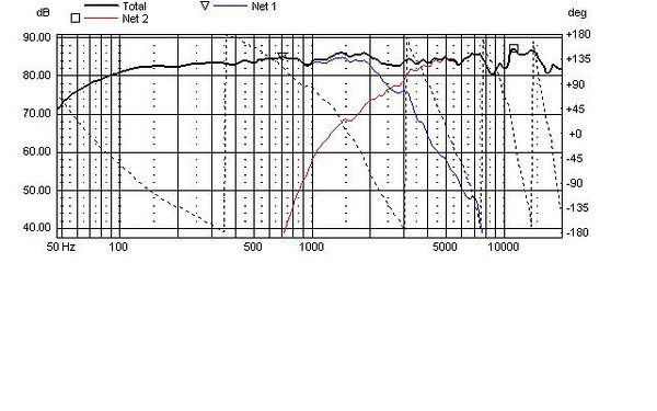

The SEAS coaxial is very good driver, in the right application. I think you have KEF SEAS reversed. SEAS I'm pretty sure were making coaxial drivers before KEF.
If you look at the spec sheet and graphs, it as a lot more promising than the B & C driver. Compression drivers all sound pretty dreadful and need confining to commercial applications and not critical listening applications. The response published by B & C is typical of the response of compression horn drivers and so is the directivity pattern.
The SEAS unit response.
The trick with that driver is to use two of them and use one driver for BSC and bass augmentation. In my hands the driver sound excellent in that center channel speaker and I would not consider using a compression driver.

Actually the phase angles are quite kind. They are in positive territory most of the time, and when negative impedance is on the high side.
His problem is that his speakers are very inefficient below 600 Hz, much more so than the specs would suggest.
I'm far from convinced a lot more power would help him. The way it is set up there will be huge thermal compression issue that won't be transient of you really put the pedal to the metal.
He likes his speakers so the best thing is to turn it down.
Ah, your right, didn't have the graph on their website so I googled it and now I noticed looking back (to prove you wrong, lol) that I was looking at another speakers phase graph. Haha.
It's not sensitive throughout the whole frequency range, let alone below 600Hz, lol. The speaker looks excellent in the stereophile measurements, except for what your pointing out. But, engineering has it's tradeoffs. This is really a speaker that covers the entire audible spectrum with very flat response.
I know what your saying about the thermal compression, but if it's just with peak and it's a ported enclosure won't the voice coil cool pretty quickly?
