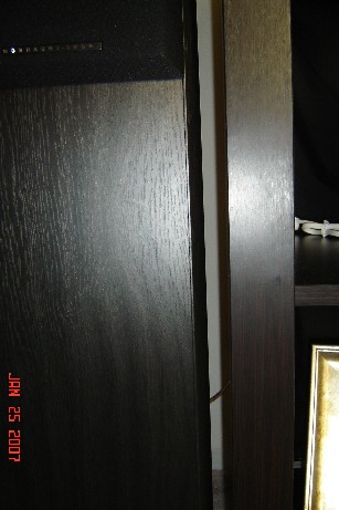

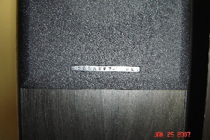

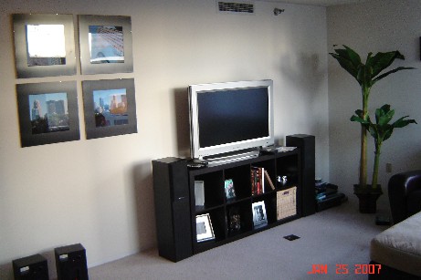

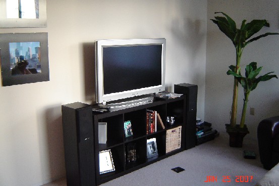

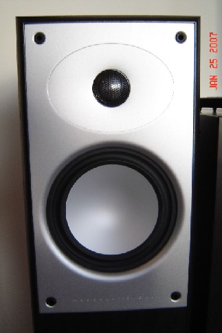

There they are: (no pics of the NAD, but you can kinda see it under the dvd player in the corner)
Note the similar finish
Pretty...

I was playing with the receiver this morning, trying all the buttons. And bass EQ just makes the bass loud and muddy. The best way to get just a little bit of good bass is to turn up the bass knob an eighth of a turn, any more and it gets muddy too.
They are too close together, and they shouldn't be flush with the rest of your gear. I'd pull them away from the gear at least a foot and out at least 6". They look great though. Better than the last black ones I say.
These are the WAF positions of the speakers. They will certainly be in these spots when people are over. When really listening, I will remove the grills, move them out and set them 8' apart. Or for a movie night.
