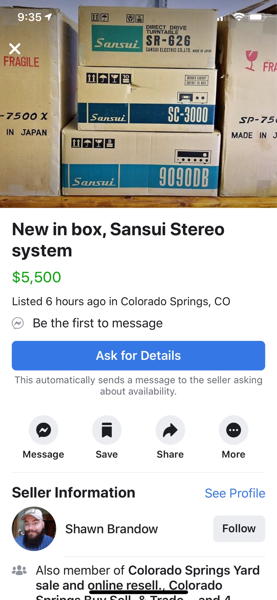

I’m not selling this but it’s advertised on FB near me. Advertised as all new and unopened.
KenM10759
KenM10759
While it's very desirable classic gear, the seller is hopelessly optimistic that it's worth 4x as much as the highest going rate. Perhaps he or she feels that because it's new old-stock and all together that it is worth more, but that's just crazy pricing.

The seller probably figures it doesn't hurt to shoot for the moon! Who knows but some guy who really thinks vintage is just the cat's meow will pay for it!
That said, I believe the receiver is the only item that is really a classic piece of gear! I'm sure the turntable is a good solid machine but as far as cassette deck and speakers, I would not expect any greatness out of them! Still, need to see oh deer like that still unopened. There must be a story behind that. Also have to wonder if the capacitors have been completely discharged and whether the receiver is capable of functioning as it should after so many years.

There isn't a definitive way to know, Kurt. Personally, I think it is likely NIB units like this would just power up and work properly. But there's no easy way to know for sure.

To play it safe it should be brought up slowly on a variac if it's truly been idle for 45 years. Then tested on a bench. There are no special or exotic transistors in the 9090 so regardless of what happens it can be restored. The db board can be problematic but there are workarounds. The 9090db has more power than the regular 9090. Very different animals internally.
