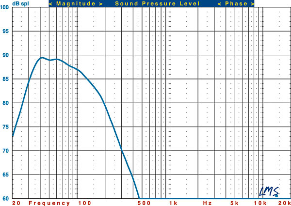

Based on this measurement graph here:
The 10S’s close-miked response, normalized to the level at 80 Hz, indicates that the lower –3dB point is at 30 Hz and the –6dB point is at 27 Hz.
and fairly high distortion and very little to no bass below 30hz:
I'd recommend adding one extra c-note and going with SVS PB1000 or Monoprice's 10 THX sub.
