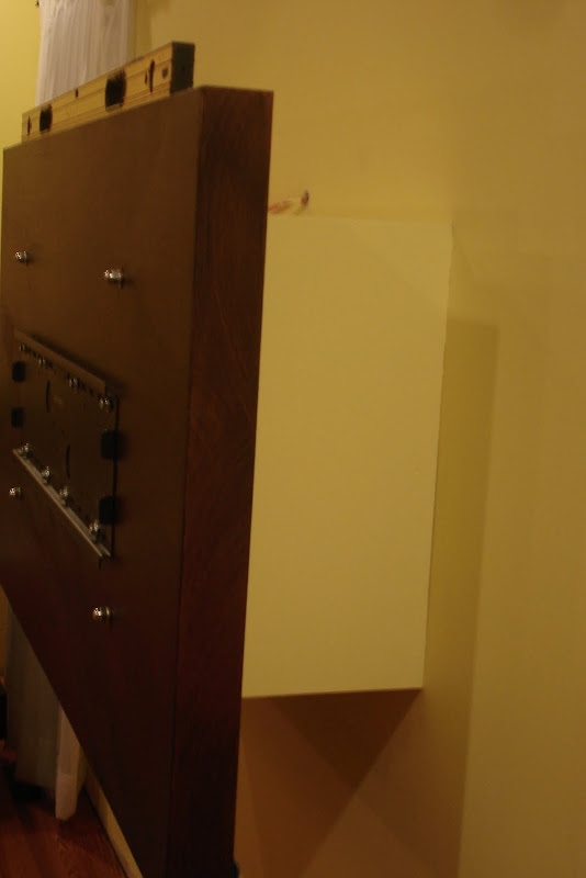

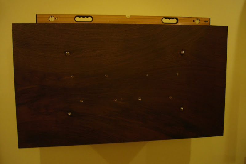

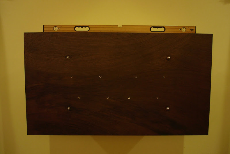

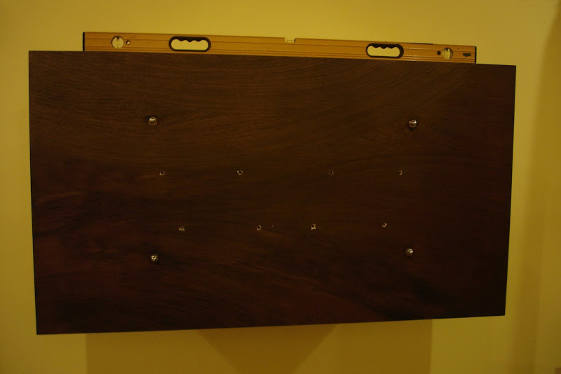

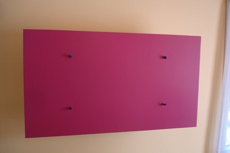

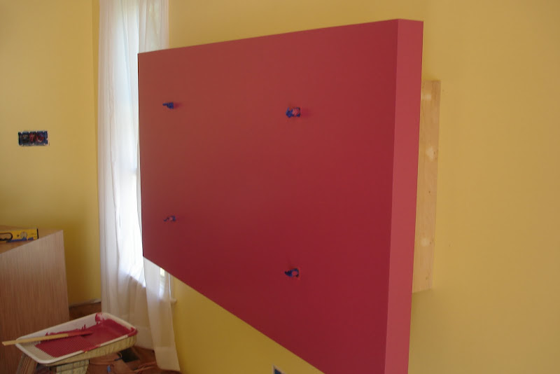

Heres the front waiting to get it's second coat and the wall paper brush treatment, I think it's funny to start with the pink but that's how the recipe calls for it to be done, lol, kinda kewl don't ya think.

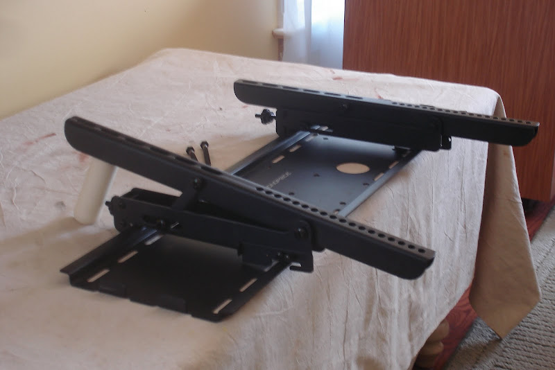

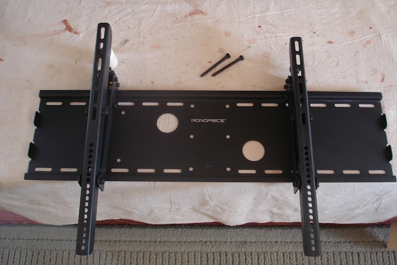

I have the same Monoprice tilting mount on my outside plasma but I paid 19 bucks for it.![]()

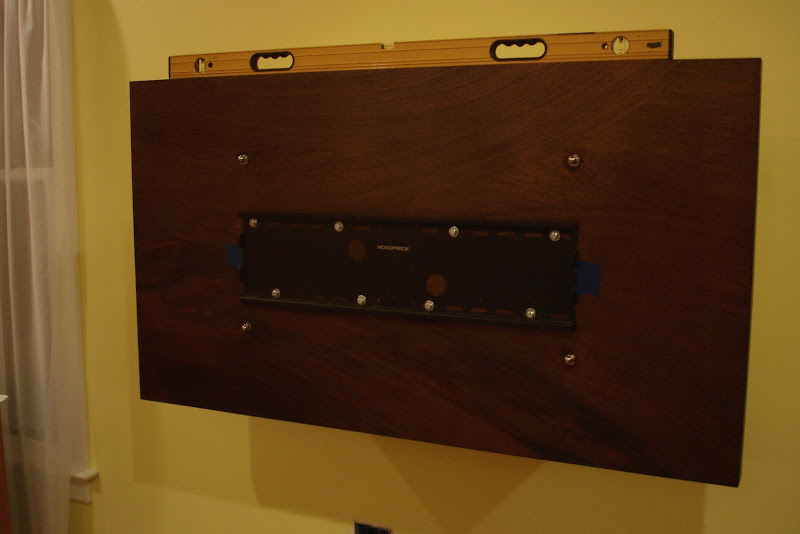

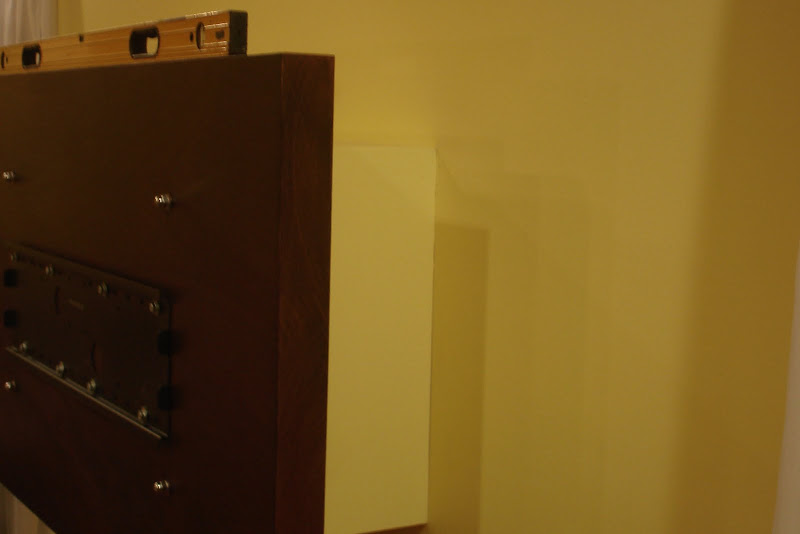

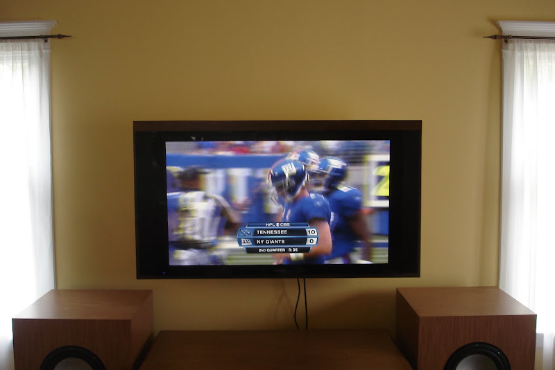

I am going to start the final coat on the front today and hang this beautiful Monoprice wall mount, my son will be here for the weekend so I will get the help I need to mount the Pio 500M, I am getting somewhat anxious to do just that as this is my Football viewing room and I miss it,lol.This is the tilting mount from mono somewhere around 39 dollars, just can't beat the product anywhere anytime no way, and I also got two of those handy 90 degree HDMI plugs male to female so that I can go straight through the build into the hollow cavity behind. I think since the center channel will set right under the display I can make a three inch w by one inch deep channel out of birch and take it from the bottom of my build to the top of the base board to run two HDMI cables, I will simply paint it yellow to match the wall behind and call it a day only two or three inches of it will show so it will surely disappear. I want to avoid the idea of running the HDMI inside the wall cavity only because there are already two dedicated 20 amp circuits(Remember my EMO) and a 15 amp that runs around the perimeter of the room, I would prefer to stay away from all that just to kind of isolate the HDMI some.
I came off the 15 amp circuit with a 14/2 and put a receptacle inside of the wood mount so that the power cord for the Pio had it's own home nothing else really on that run except an occasional sweeper or reading lamp.

This is the first coat
What do you fine folks think?
another look:

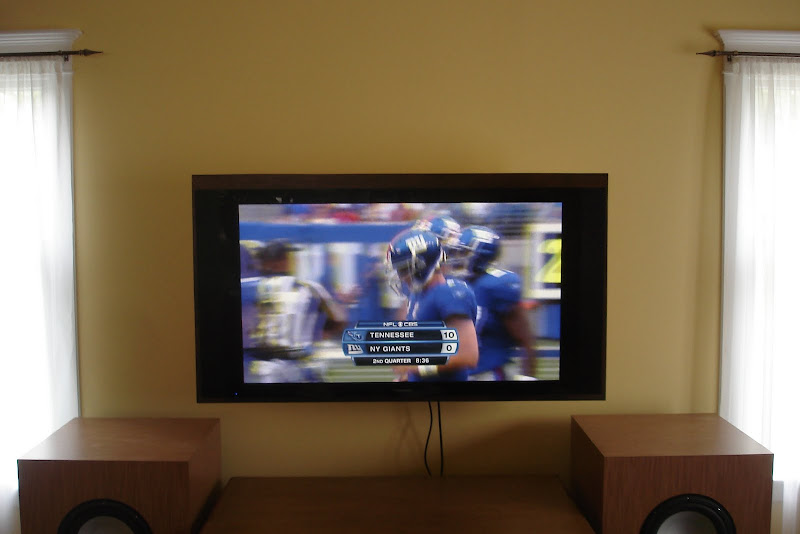

I figure the box only needs to be the size of the mount and that would add the the illusion of the TV floating in free space. Now it's my turn to thank you for the inspiration. I meant to ask you if you are EQ'ing the Kappas with a Behringer 2496.
Something tells me you live alone.... what do you think of black?
Have you ever noticed that essentially every screen border in the world, no matter a +$200 Focupix, or +$4K Stewart, has a black border?Something tells me you live alone.![]()
