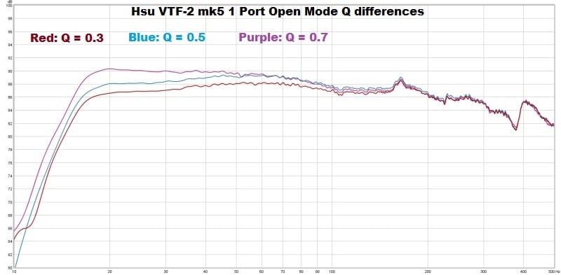

You are still getting 18 hz, just not quite as much of it as you would were the Q set to 0.7. It is about 3 to 4 dB down compared to 0.7 Q. That is about a 50% reduction. This graph illustrates the changes:
have no idea how to read graphs.
many, many thanks for that info though. maybe i should set it to somewhere in between .3 and .5 and id possibly gain a db or 2 of 18hz and still get that .3 punch i hear/feel that i didnt when set to .7
