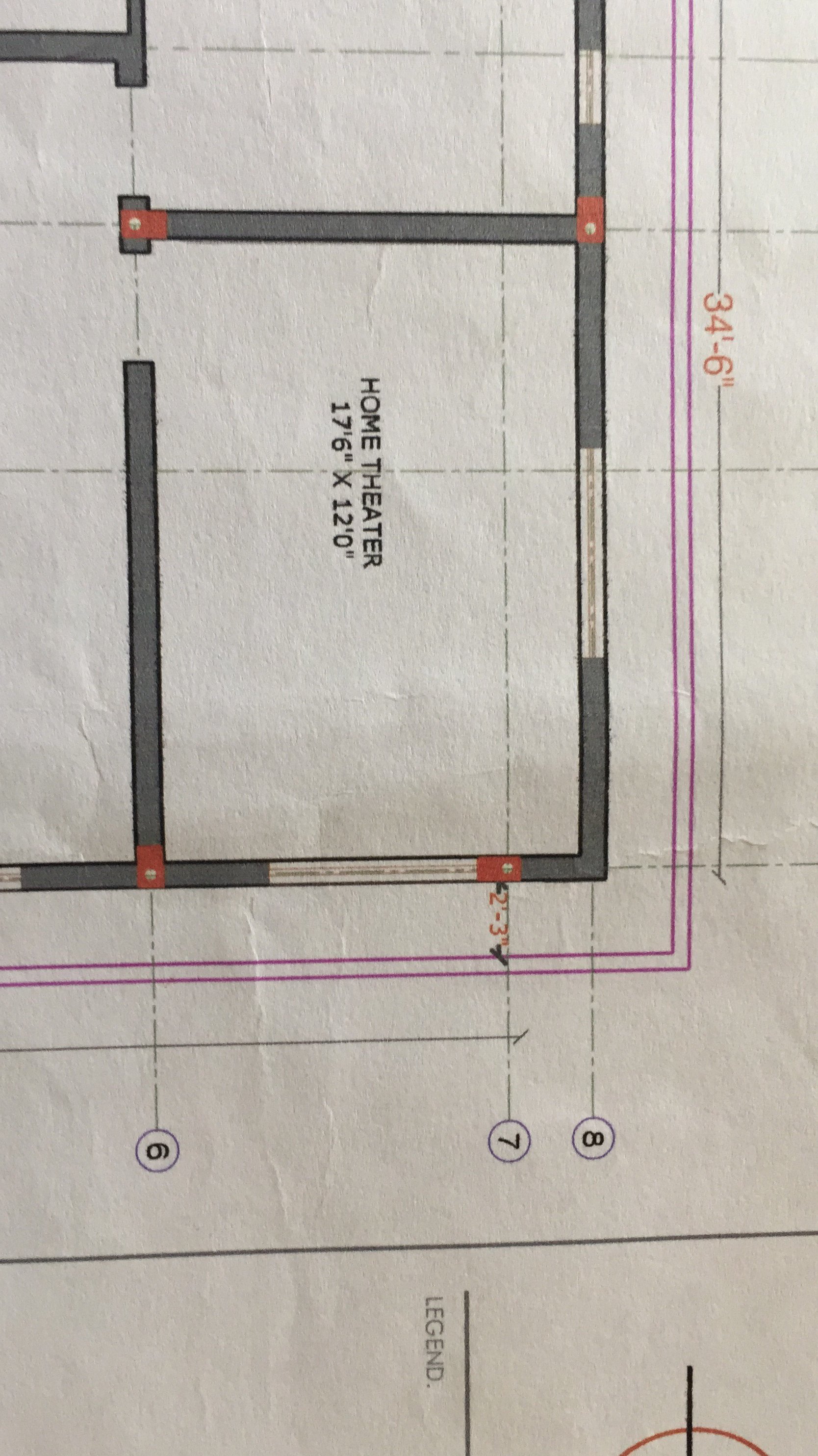

  • Option for Dolby comes in the audio adjust option in the manual which I did not understand.
  • I have attached home theatre lay out plan I don’t know how to figure out height in that diagram
  • With regards
  • Vinayaka
