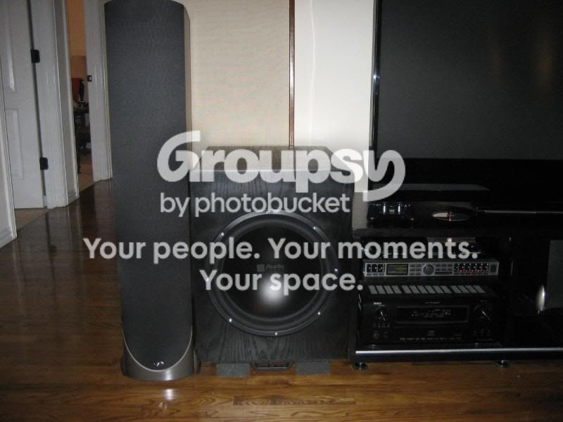

That looks a lot like my sub.
Don't you guys love how I just post all my pictures over everyone's threads?
