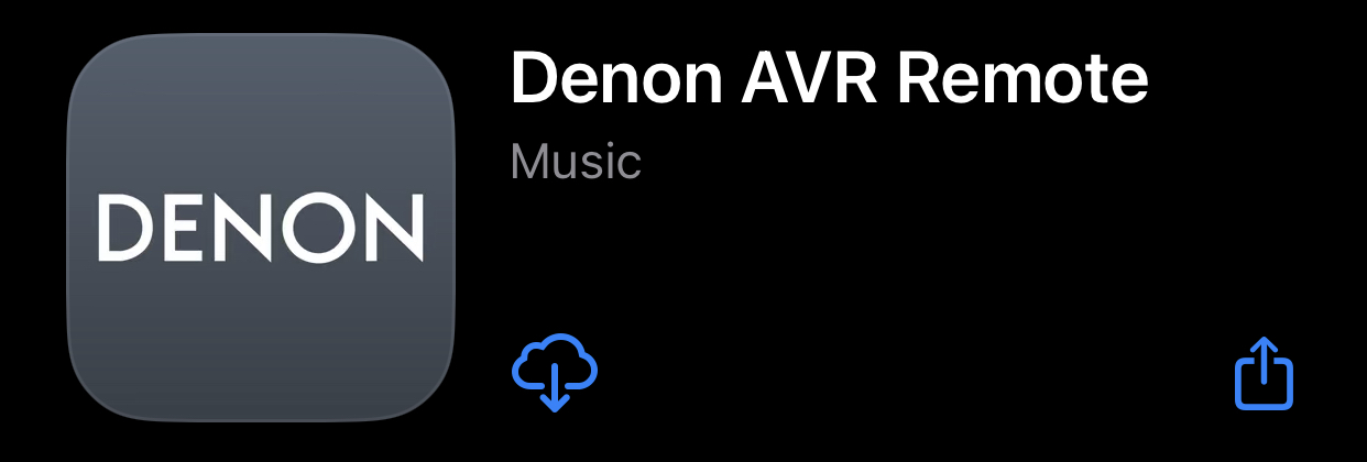

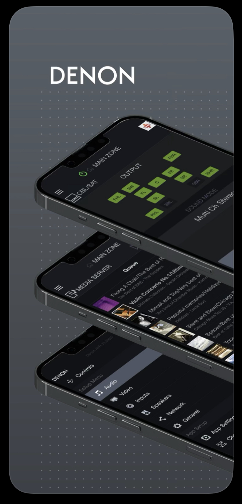

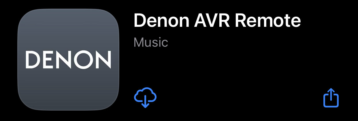

Right, and with the Denon app, control of a blu-ray player with HDMI-CEC on will be possible but Denon stopped short of saying it would work with anything but one of their players. No telling until one tries it.
Nobody needs line of sight for anything! They need a control system that uses RF communication between the universal remote and hub, or the smart device and hub. Some of the available hubs can control equipment via IP, if the equipment allows it, or it can use IR/IR ports to control everything that doesn't (stupidly) require badly thought-out BlueTooth for control.
Trebdp83
Yes, that is an option. The system here may need no additional equipment when the Denon is connected to the network and HDMI-CEC is enabled in each device. The Denon AVR Remote app will control the Denon receiver and it will, or may, control a connected blu-ray player using HDMI-CEC. This works with other makes and models of receivers and players. I can do as much anywhere in my house using my Onkyo controller app to control my Sony UBP-X800M2.
B
blackboar
I can confirm the Denon app does not work with this Sony blue-ray player. The app will switch between inputs like Cable/Sat and Blue-Ray but will not actually control the device.
