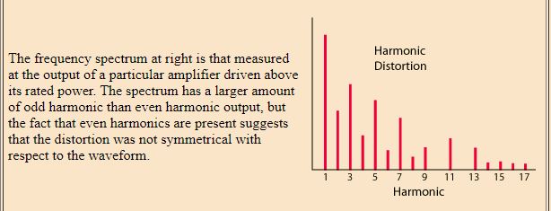

I'm a little late to the party, but I've got a some input to toss in...
I've seen two theories (that aren't mutually exclusive) on why an under powered amp is likely to damage a speaker. The first has already been brought up, i.e THD from clipping shifts more content towards the tweeter.
The second has to do with the compression associated with clipping. Suppose someone was pushing an amplifier to the point where it was clipping/compressing the peaks. Depending on the duration of the clipping and the program material being used, the user may not really notice anything amiss. However, that compression could be the difference between "it's loud enough" and "crank it up another 3dB", doubling the average power delivery from the amp to the speaker, and leading to more distortion to the tweeter.

Of course Hyper Physics was right!:D The only caveat is that what you quoted has to do with clipped wave that are symmetrical. In practice, I would assume in severe case of clipping, the waveform would likely be asymmetrical, at least slightly, so I don't see the need to exclude even order harmonics though their magnitude would be much lower perhaps to the point of being insignificant. I have recently started the process of gradually sorting and sending my university text books and notes to garbage, now I feel like keeping anything that has to do with audio and Fourier.:D:D
OK. Should have read further into Hyper Phys

Yes, it contains even harmonics but at a much lesser amount when signal is not symmetrical.
ps. Just noticed the 10th and 12th harmonic is missing. Wonder why.
Wow, thank you for the follow up. It has been so many years since I study Fourier, as part of the communication course so memory is fading.. You've just brought up another key point that is worth noting. In the Hyper Physics example, you can see that by the time it gets to the 17th harmonic, the magnitude is already disappearing small. 17th harmonic of a 1 kHz fundamental is 17,000 Hz, that would certainly be passed onto the tweeter, but again, the magnitude of such high order harmonics resulted from clipping may not be as damaging as people made them out to be.., and obviously this particular point is contents dependent.
Once again, most of the time the appropriate answer to the question raised by ADTG, really should be "it depends.." The dependent variables should include, but not limited to: media contents being played when it clipped, severity of the clipping, the specific speaker (tweeter rating, crossover design/specs) and the specific amplifier (power rating, distortion profile, with/without soft clip by design, sharp rise in distortion after knee point, types and characteristics of the amp's protective features etc.) being abused by the idiot and how much of an idiot the idiot is?
Check THIS out, particularly section 2 on amplifier clipping. It seems to directly address your question. It's also relevant for @PENG's and @mtrycrafts discussion of the relative power of harmonics.
...In the Hyper Physics example...by the time it gets to the 17th harmonic, the magnitude is already disappearing small. 17th harmonic of a 1 kHz fundamental is 17,000 Hz, that would certainly be passed onto the tweeter, but again, the magnitude of such high order harmonics resulted from clipping may not be as damaging as people made them out to be... It depends........
