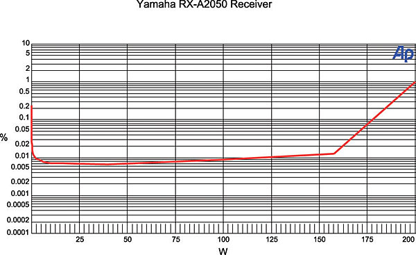

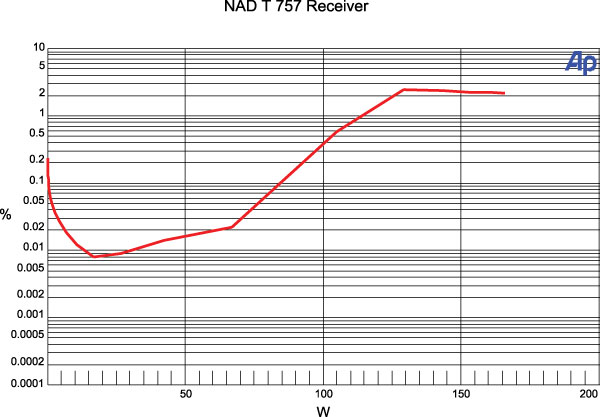

May be that particular Kenwood model would clip very badly as soon as it crossed a certain threshold, whereas your newer units would clip in more of a gently progressive way as output increases.
In fact if you look at the S&M and AH's bench test power vs THD graphs, you can see that some AVRs do have a more gentle slope after the knee point, whereas some just went straight up like almost 90 degrees.
Regardless, if as soon as the distortions became audible you turned the volume down you might have not have blown the tweeter, but you waited right:D? You said you even try to blow that the same tweeter with your Yamaha, sounded like you wanted an excuse to replace the speakers.:D:D
Before are just a few examples, not also NAD claimed to have a "soft clip" feature.
https://www.soundandvision.com/content/anthem-mrx-710-av-receiver-test-bench

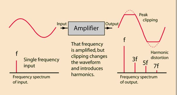

A clipped periodic waveform can be represented by an infinite series containing the fundamental frequency and the harmonic frequencies. For example, when a 1 kHz sine wave signal clips, you will get in addition to the 1 kHz sine wave, a series of harmonics that may include 2, 3, 4, 5,............................
Hyper Physics shows only odd harmonics:
Am I wrong on this?
Are they saying just the distortion itself, regardless of the Power or Energy going to the drivers, is causing all the damage?
I assume they mean "a lot of distortion" in the form of "clipping" that causes more ENERGY (and high-frequency energy shift) to go to the drivers (especially tweeters).
But it makes sense to me that the excess ENERGY is what causes the damage.
If distortion occurs but the resulting energy is less than the limits of the drivers, how would this damage the drivers?
Am I wrong on this?
Of course Hyper Physics was right!:D The only caveat is that what you quoted has to do with clipped wave that are symmetrical. In practice, I would assume in severe case of clipping, the waveform would likely be asymmetrical, at least slightly, so I don't see the need to exclude even order harmonics though their magnitude would be much lower perhaps to the point of being insignificant. I have recently started the process of gradually sorting and sending my university text books and notes to garbage, now I feel like keeping anything that has to do with audio and Fourier.:D:D
