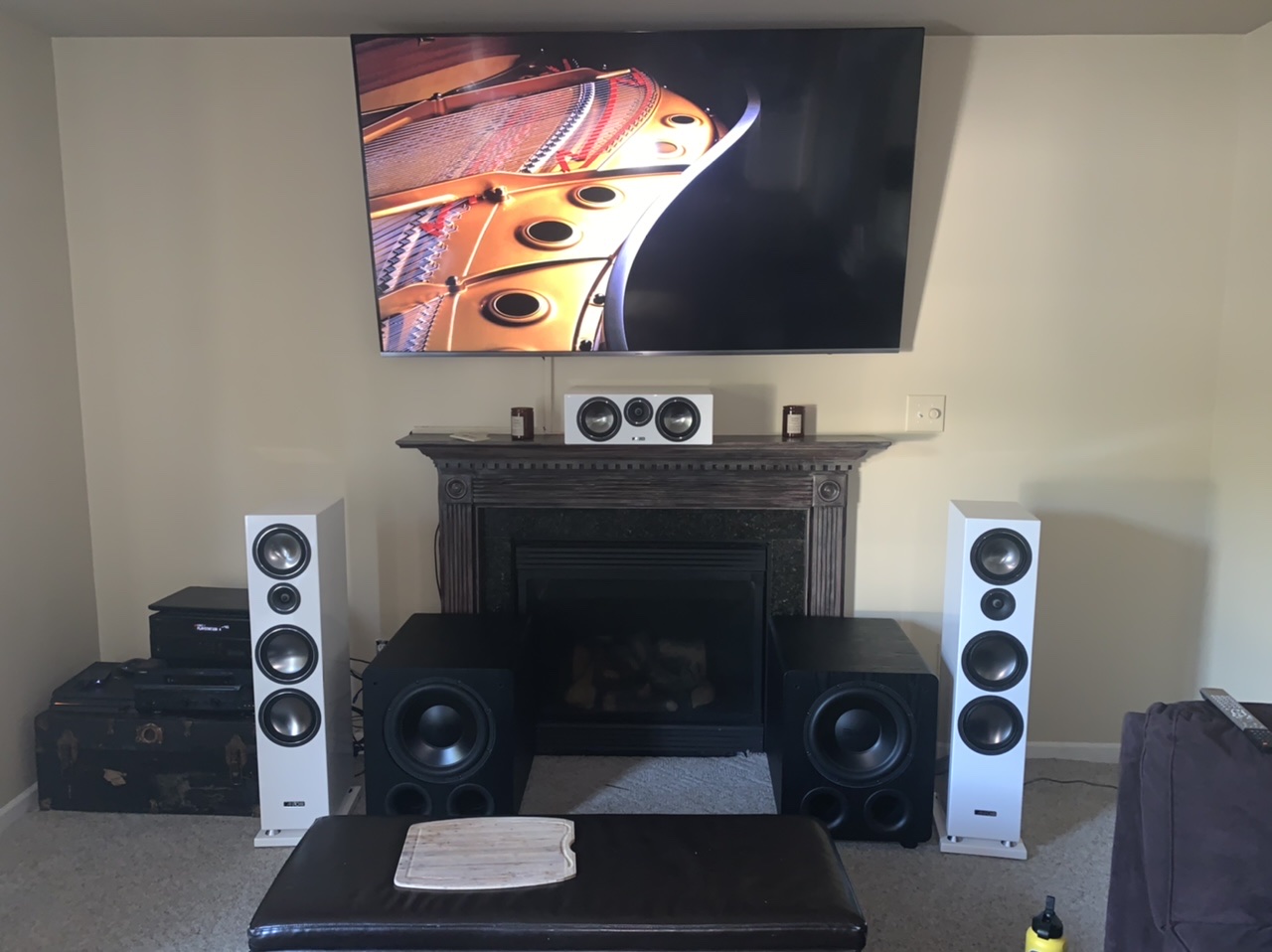

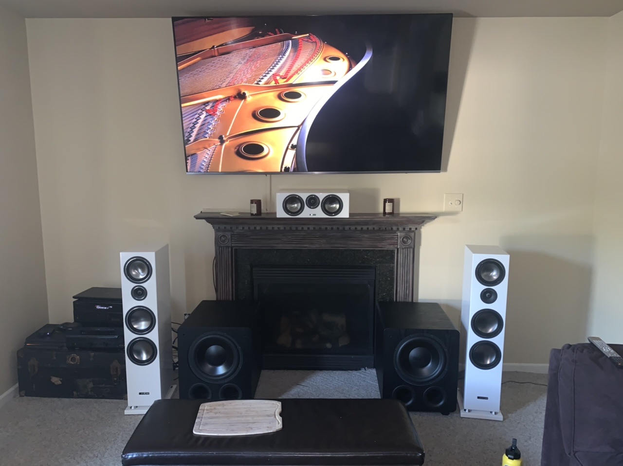

Here is a picture of my set up. Canton Chrono SL 596.2 Towers, Canton Center and 2 PB3000’s up front. Have Fluance bipoles for Side Surrojnds and 2 Polk for rear surrounds. I’m new to REW and was considering getting a mini dsp. These are a couple of my results. The red line I used Room Gain Comp and PEQ to flatten it out a little bit. Does this look good? Would I benefit from a mini dsp? Thanks in advance for the help.

Same as the other post I made... kick it to 1/12 smoothing. In general it looks OK. Would be nice to see a full bass sweep from as low as it wil go up to around 200 hz. :)
It looks as if you need to turn your subs down. This is a very common problem. Hot subs spoil good reproduction and markedly reduce speech intelligibility. I know you paid a lot of money for them but running them like that produces sub optimal performance.
