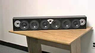

I've looked into some Atlantic Tech speakers and notice this sound bar when looking. This one looks pretty stout. This one or at least one of theirs has spots for 5-7 speaker inputs and this runs from an AVR not a small amp in the soundbar.
I was thinking about this. If so many people are thinking this is adequate to watch TV (with at least a sub for crying out loud) and it probably is to be honest. I bet that does well. It made me realize that pretty much any 5-7 channel system of reasonable quality is probably overkill in most instances. But I love overkill. Still the one below looks like it would be great for a kids room or for my daughters rooms at college. That said I bet they wouldn't want to have to deal with the AVR needed to drive it.
