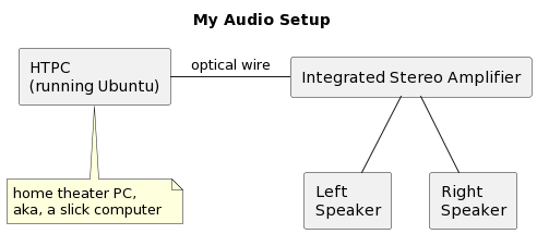

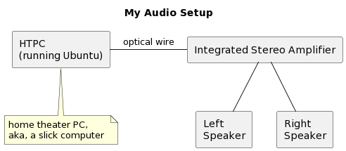

I used to set my pc at 100% volume and control the AVR output with the remote but got tired of messing with batteries for said remote. Now I set the amp (in my case an old Denon AVR) that's hooked up to my pc to less as a form of protection on some speakers I hook up to it, and control the output from the volume + - on the pc keyboard instead.
I also control the subs and dsp from the desktop as well. I have noticed no audible difference doing it this way as far as sound quality is concerned after having done it both ways. This way, I can sound level and control everything on the fly from one place. This helps me adjust without volume normalization having to be included in some software like when playing CDs from the same system. I have always used EQ/tone controls on the fly since I started listening to music on my own.
It is a matter of preference, though technically speaking it would make a difference in terms of SNR, that likely has no audible effect in most cases.
PENG
Hypothetical or not, this helps a lot.
In this case, you basically have two volume control, one being the HTPC's windows, or MacOS controlled "Volume", and the other is the volume knob on the integrated amplifier.
You obviously know that an integrated amplifier is an amplifier that has both preamp and power amp in one box.
