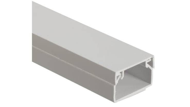

If you don't have access to the walls or ceiling, speaker wires can be run inside small rectangular conduit which can be surface mounted and painted the wall colour. Running the conduit along baseboards and door frames cab blend in better.
