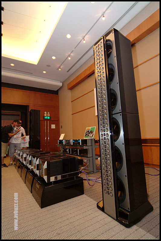

Yes, even the stereo in the picture[which is probably more impressive looking than it is sounding.
Ya that is right all show and no go.
And to hell with this high end Mcintosh system because it is all show.

Buckeyefan 1 said:
This guy probably doesn't use an equalizer.
Nope, for sure. Look at all his wire lifts :D
His room sounds very bright looking at the floor behind the speakers and walls. What does he care about good sound. He is interested in impressing people. :D
