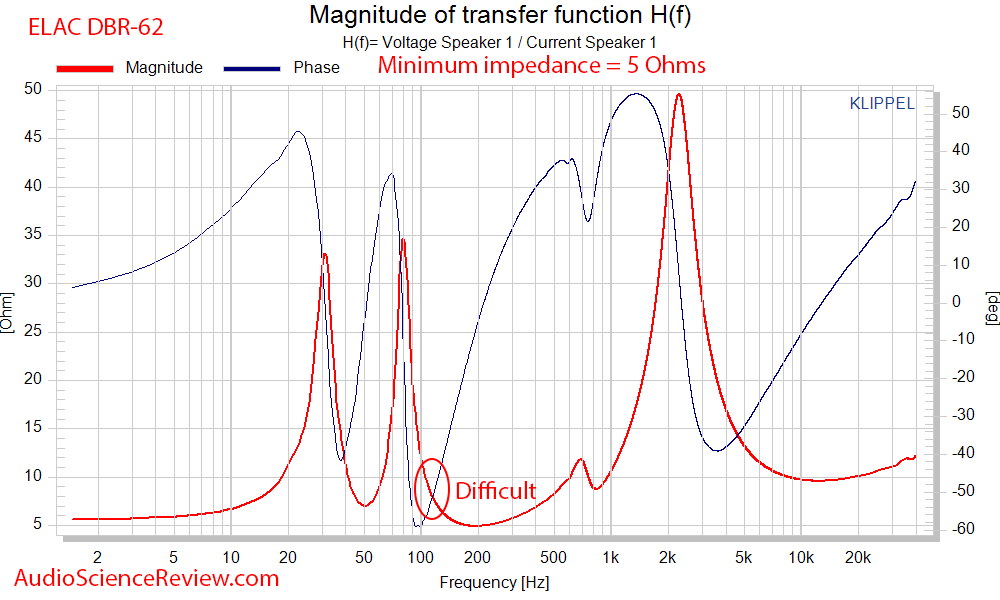

The Ref DBR62's impedance/phase angle graphs are similar to that of the B6.2 so my same comments on the B6.2 still apply. Whether it would sound better to you is hard to tell as it depends on your personal preference, though based on measurements it seems like a relatively neutral sounding speaker to me.
Elac Debut Reference DBR-62 Speaker Review | Audio Science Review (ASR) Forum
The bottom line is, it is down to your listening habits (how loud, kind if music etc., your room size and distance seem fine) that determines whether those low power amps can drive such speakers to their best.

The Ref DBR62 should sound better judging from the measurements, but the impedance/phase angles are no better than that of the B6.2 so my same comments on the B6.2 still apply.
