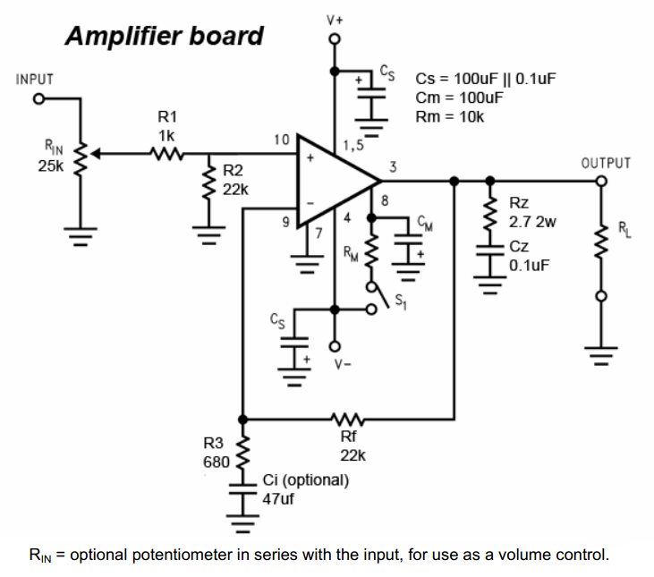

That's just one example of something that is not audible but measurable and found not insignificant as shown in JA's measurements. It is funny that many audiophiles worry about things that they claim are audible to them, but not measured, or measurable by audio test benches (so they claim).
Well, noise at high frequencies may not be audible, but it may be important!
The output is fed back into the input as part of the negative feedback circuitry. Noise at freqs above the human hearing range will get fed back on the negative feedback loop.
I don't know "how important", or "what noise in the high freq is acceptable", etc, off the top of my head. But, I'm fairly certain that I have books that will educate me on the topic.

I don't think so, not for the very high ultrasonic noise. Any such unintentional feedback would be negligibly low or could be filtered in the loop. I'll think about it though.
True enough on the filters, and a cap in the feedback is common, but I'm not so sure that its primary purpose is for filtering.
Yeah, let me chew on this one a little, and likely go have another skim through the literature.
We can compare notes later.
