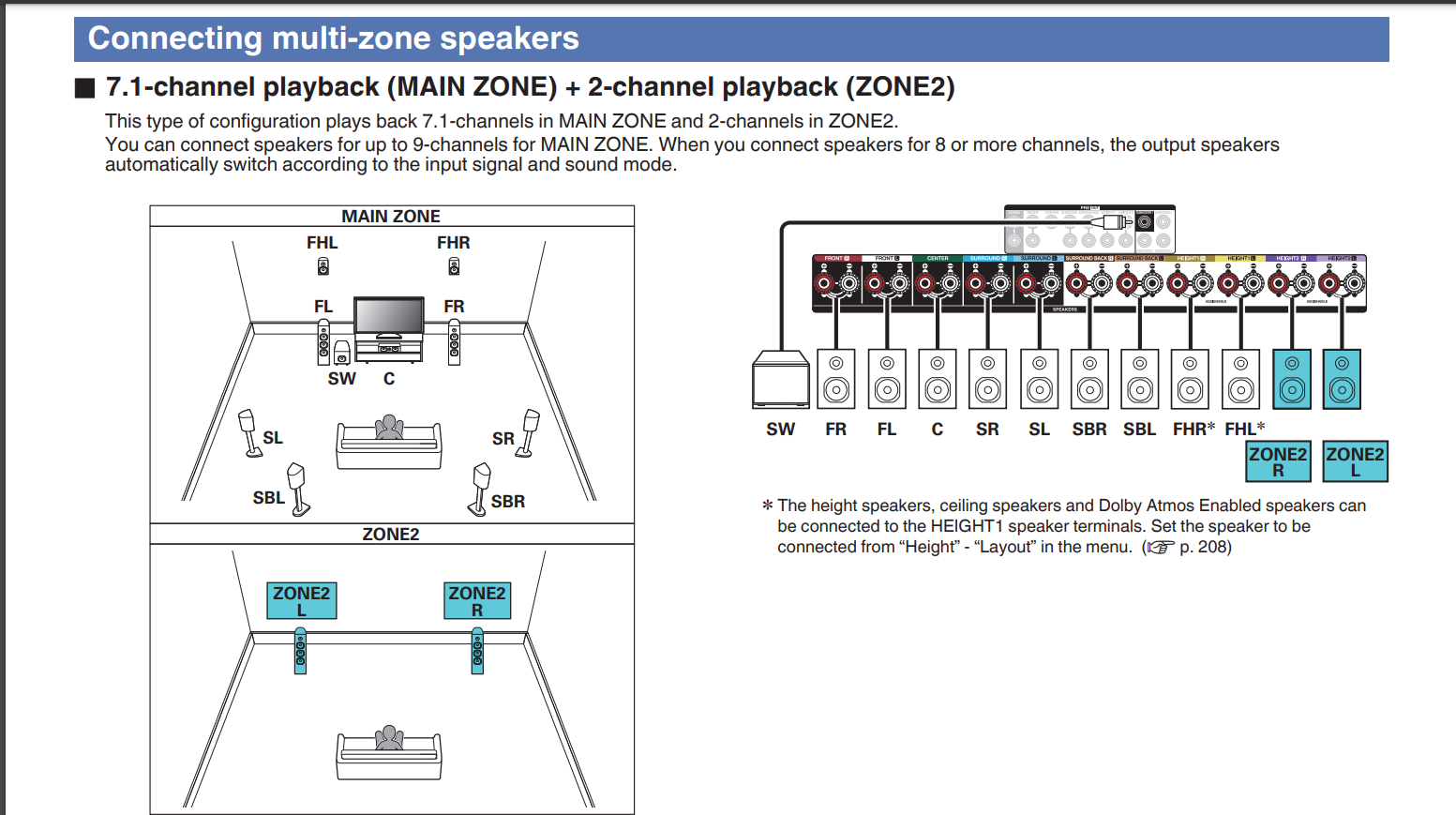

I've read through the user manual of one of the receivers (image below) and it seemed like software-wise, I was limited to a 7.1 channel surround if I wanted to utilize a Zone 2 at the same time

what I mean is that, I know that I need 11 channels (whether that be 11 right on the AVR or 9 on the AVR plus 2 on an external amp). What I am asking about is the software. Will the software let me configure these 11 channels to run in a 9.1 + zone 2 setup?
Looking at the manual, it doesn't seem like any of these receivers supports that in software even though all receivers support up tp 11 channels
As another example that I just found, the Denon x6700h has a page in the manual that explicitly talks about how to setup a 9.1 + zone 2 setup.
So, it's unclear to me whether the Marantz Cinema 50, Denon x3800h, or Onkyo RZ50 support a 9.1 + zone 2 configuration in software, evem though they all technically support 11 Channels

Should just be an amp assignment setting in a Denon or Marantz unit.

Yes, and if it were me, I'd use a separate amp to power the zones even on the models that have the amp channels aviable to do it.
It can be confusing when setting up Zone 2. If you are NOT going to use an external amp for Zone 2, you will lose two amps in the receiver to power Zone 2. This means losing two height speakers in a 5.1.4 configuration in the Main Zone while powering Zone 2 with a 9 channel/amp receiver. You will need an 11 channel/amp receiver such as the X6700H that can power a 5.1.4 Main Zone and a 2.0 Zone 2 simultaneously and configure it to 9.1 + Zone 2.
If you do plan on using an external amp for Zone 2, you can configure the Main Zone to 5.1.4 in a 9 channel/amp receiver and lose nothing when Zone 2 is on and the signal is sent from the Zone 2 pre out to the external amp. The controller app of a network attached receiver will allow full control of each Zone. However, there are source playback limitations regarding output to Zone 2 so check the manual of the selected unit for details regarding those limitations.
Powering two zones with eleven amps using one receiver is a tall order for any unit but offers the most control and convenience when using a controller app. You can select streamed music from various services for Zone 2 and adjust the volume levels of the 2.0 speaker configuration while others are in the Main Zone watching a movie using all of the speakers of the 5.1.4 configuration.
If one is already using a network connectable receiver of a particular brand and will use it to power Zone 2, staying with that brand when shopping for a new Main Zone receiver may make network control easier as both receivers may be able to be controlled from a single controller app if they aren’t too many years apart in production and are supported.
