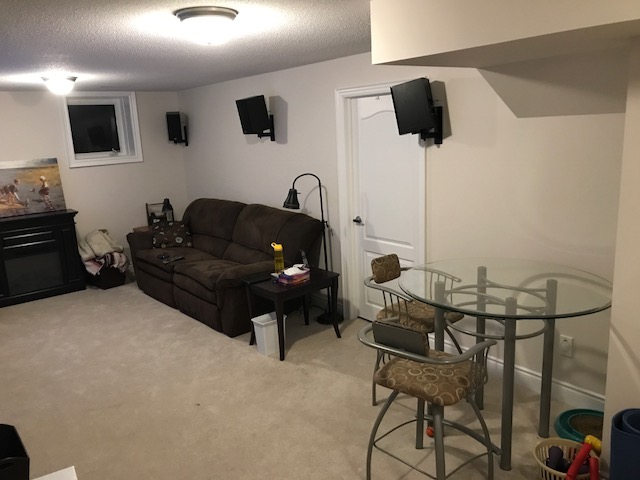

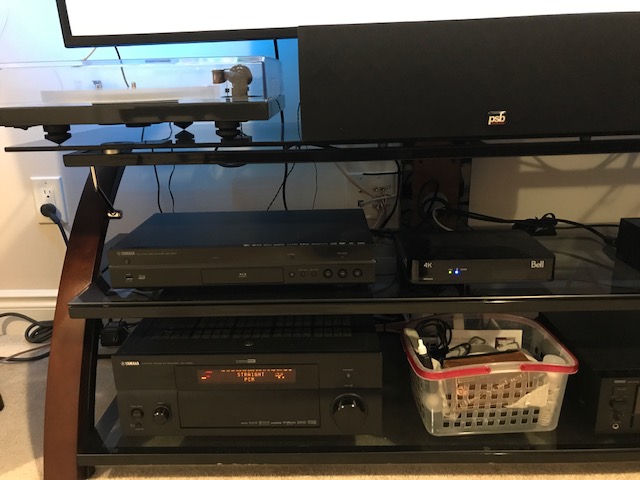

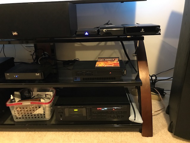

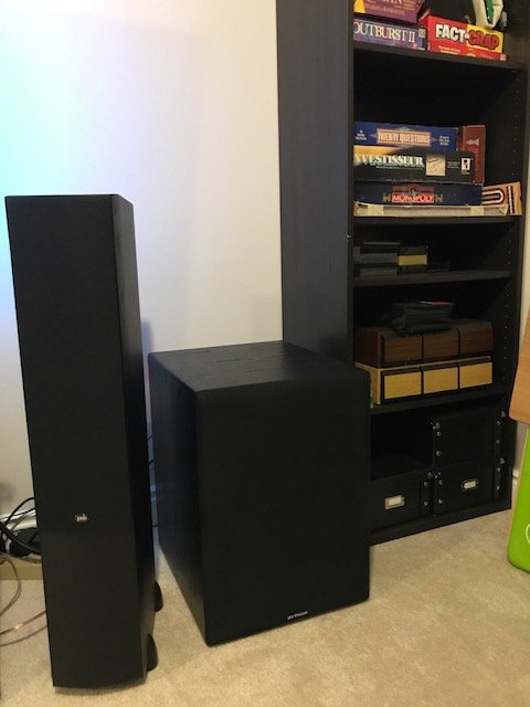

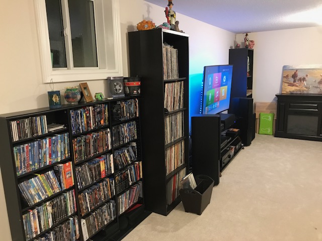

Here are some pics of my main setup in the town house so space is tight..
