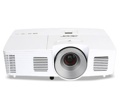

What about this 720 I highly recommend it. Picture quality is great. The remote/power cord can be bought on ebay:

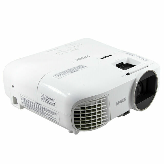

So, you are fighting at odds with reality.
"I want something bright, small, silent, high resolution, and super cheap... with plenty of zoom and lens shift."
YES! That's what we ALL want.
It's completely unreal to ask for, and doesn't exist. If you find something that makes the claims for what you want, when you visit their website you will find out that they don't even have a manual for you on their site, let alone a support phone number or a good email address.
The best, cheapest, 1080p, nearly silent projector on the market comes from XGimi. It's not exact tiny, and it is nowhere near $200. More like $900...
Plus, it STILL doesn't have lens shift or zoom on it, so you get zero placement flexibility.
If you want placement flexibility, zoom range, a bright image, low noise, and 1080p resolution, then you should get the Epson 3100 or 3700 models.
Still - $640! WHY? Because that is simply the price of a high quality 1080p projector with the lens capabilities you are asking for.
Kinda hitting more of a budget point, the Epson 2150, used, via eBay may be had for under $300. It should be reasonably quiet, plenty bright, has some lens shift, and some zoom range. Doesn't touch the 3100 in terms of ... everything. But, with 1080p resolution, it's a solid model and can be had for a reasonable price if you look around.
The ebayer sent me an offer for $77 + shipping. I think you can't go wrong. I would contact him and make him an offer. I'm telling its well worth it. Bmxtrix is giving you excellent recommendations as well.

That Acer is a good way to go if it actually works as advertised. Used projectors, of course, are always a gamble. But, at $100, it's super inexpensive and universal remotes are cheap enough if you actually need one.
It really is a great projector when I first got it I was amazed how great the picture quality is for being a 720p. I mean it's ebay, so if it's not working you'll get a refund. I got mine refurb from Acer and never had an issue. Only a bit of dust and they can be fix with a blower. I'd love to go 4k/3D, but waiting for prices to go down, but I have to say the Acer is still great. It's the only thing I bought to Florida with me electronic wise, besides headphones.
